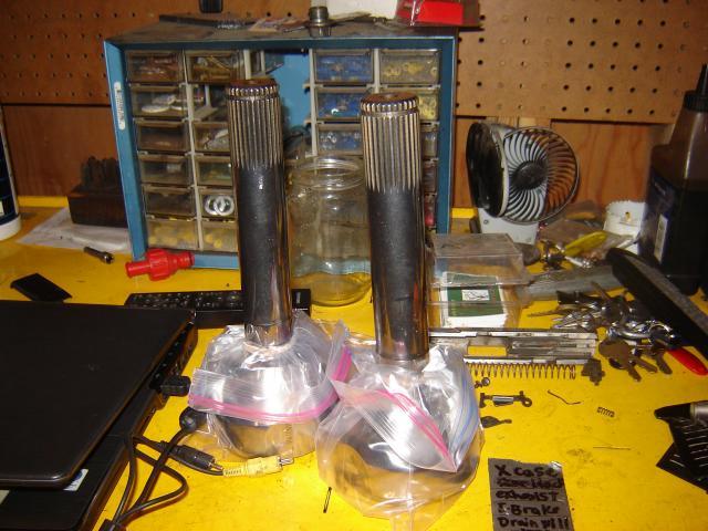

Now I have to get motivated and get these installed .Thanks mister long :awesomework::cheer:
30 splinerz
are those the 30 spline or did you just get the 27's? wheres the the inner axles? Did you get hub gears too?
The new Inner axles are sitting on the bench and use the same stock hub gears he said!Who told you u need hub gears?
i was just asking if you got them i know he has a package deal that comes with the hub gears.....thats all! nice bling bling!! Did you at least get some stickers...LOL!!!:cheer:
If they are bobby's chromo 30 splines to retain the warrantee on them you must run his hub gears....
When you break the hub gear and it Fs up the birf you will know why you need hub gears.
Thanks so much to you and Money for the longs!! K2Blazen and I are going to be having some fun tonight in his nice warm shop! were going to have an axle party!! getting ready for reiter this weekend!!:awesomework:
I see
Just checked them out I'll get them next week.Thats the next weekest link strips the end of the birfield out it said .Did not know that.
