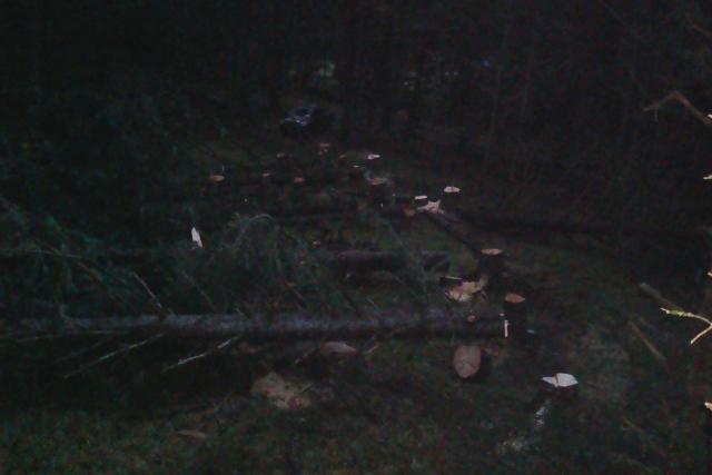

Didn't get very far today pinched and twisted the sproket of my bar so got to quit early.
Here is a pic of to see if you can spot my f-up. Probably alot, but one big one.

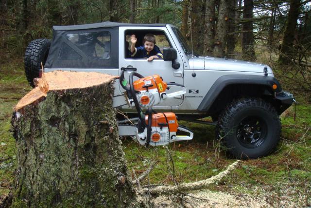

Then one of my helper and a couple of smaller saws.
Really hard to see with the dark pic... But did you cut through your hinge on the stump lowest in the pic and the tree rolled sideways off the stump as it fell grabbing your tip?
I can't really tell which tree goes with which stump...
