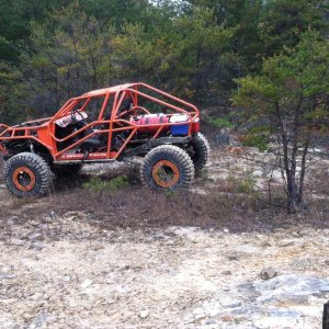

I've got 4.2 with 4.0 head and hessco can,t 18 and d300 case. Dana 60 and dana 70 ,14 inch coilovers all in 2 seater tube chassis. and weighs in at 3300 pounds with my 160 pounds and fuel. Pretty much unbreakable .
