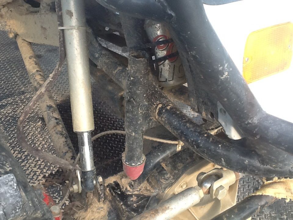

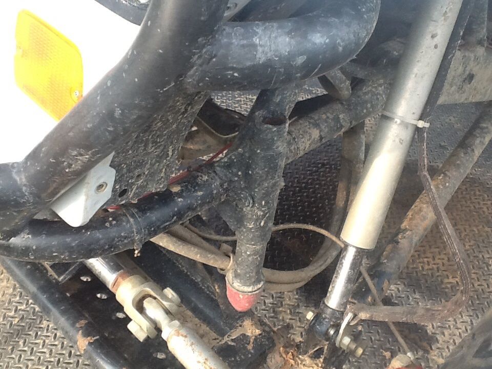

Here's how I done mine. If I had it to do over I would of made some cans that an air bump would of fit into so I could just upgrade the bump stop and not have to cut everything back off. Sometimes i can't think two steps ahead.
