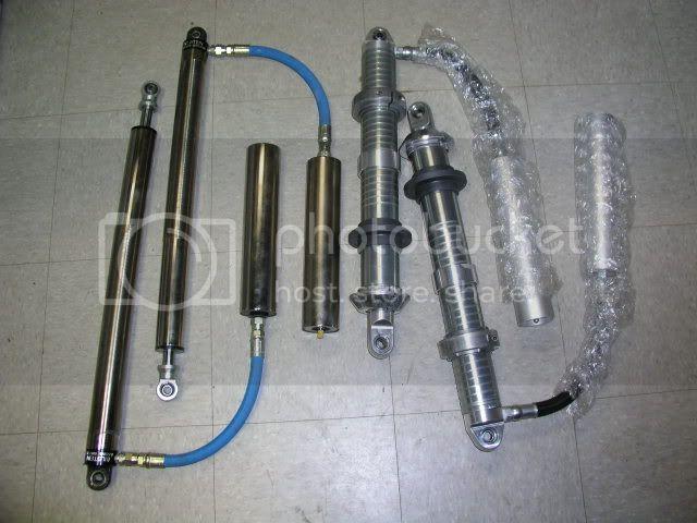

got some new bling as you rich folks call it... 14" FOAs for the front and 17" bilsteins for the rear.... :woody:
mounting pics to come... lets just say i had a house call from our favorite engineer and park owner....
caglezxj said:
Let me know how the FOA's do I am thinking about replacing my front FOX Coil overs.
they are WAY nicer than i anticipated... all the negatives i heard about them way fit/ finish... these are not mattO quality, but they damn sure are the best looking things on my buggy... but i will give them some time and let you know how they hold up....

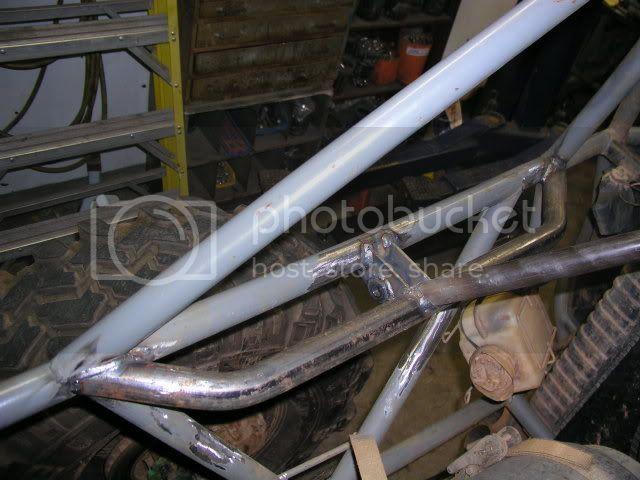

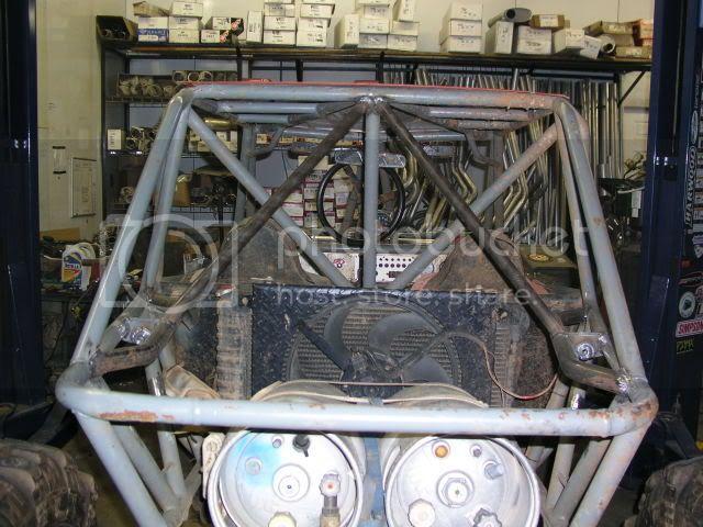

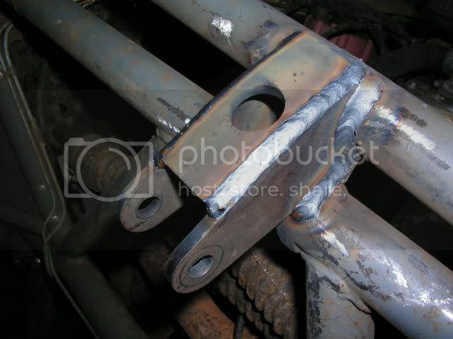

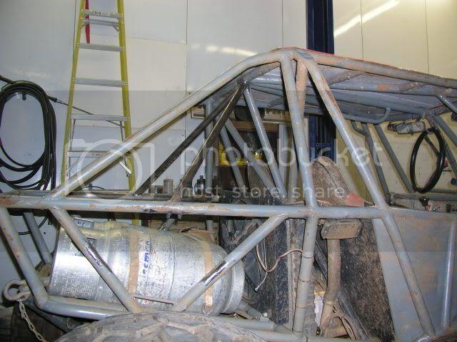

front mounts... is being tied together w/ an engine cage that i will finish tomorrow...
rear drivers side... ties into the center of the B pillar...

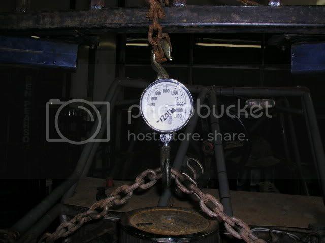

here is how i weighed the sprung weight... i bought this scale for $65 on eBay... the shown weight is 120lbs off, but you get the idea... my girl aint as thick as everyone tries to make it out to be...
front
rear
Take it down to the market and weigh that fat bitch. Your not tricking anyone by that cheap as fish weigher.
