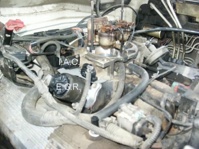

As for the actuator, is that the vaccum actuator just in front of the throttle linkage or something else? I can post a pic if that helps.

Get me a pic. And its IAC--not ICM :awesomework:
Ignition Control Module (ICM)is what I have a spare of . I already replaced the Idle Air Control(IAC). Ok Pic coming in about 10 min.

The thing right next to the PCV valve is called the "idle speed control actuator solenoid" Is that what your talkin about? It is connected via vac line to the vac dohickey under the throttle linkage.
Thats it. check to make sure you have manifold vacuum source to the control soloniod(follow the vacuum feed line from the actuator). Key on make sure you have voltage on pink/black wire. Hook up a vacuum pump and with key on--ground the dark green wire and see if the soloniod clicks and make sure you gt vacuum thru it(to the actuator)...
Idle speed control actuator solenoid seems to be working. It clicks when grounded with vac pressure or without. After clearing codes I am getting nothing right now. Will take it on a longer drive when the kids wake up from their nap. Still dieing when put into gear
Take off the IAC and the EGR and clean them. Look for Carbon deposits in the EGR holding the pintle open. Also look when you put the egr back on that the intake vacuum hole is on the pintle side of the egr. The egr can be installed backwards and then the intake vacuum will pull the pintle off it's seat and allow exhaust into the intake, causing your problem.

The EGR and the IAC are both new. I will pull the EGR to make sure its on the right way.
The CTS and O2 are also new. New plugs, wires, exh man gaskets.
