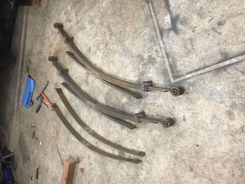

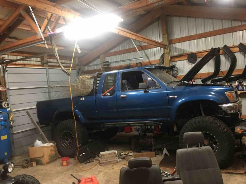

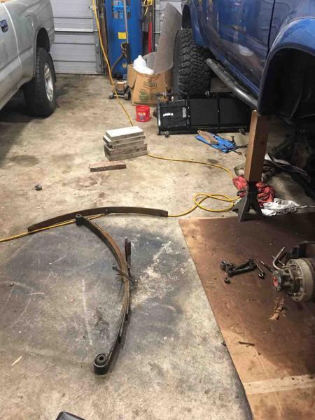

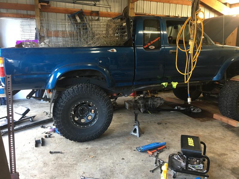

Updates since the transmission is at strange to get built gonna take some time to do some updates and make it sit lower. Pulled a leaf from the 63's and changed the rear shackles to lower it a little. Gonna source a flat pitman and some shorter springs for the front maybe Rufs we will see. :awesomework:

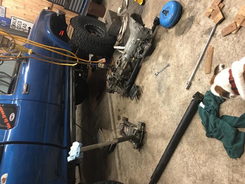

New transmission will be done soon had Will at strange auto redo it with these upgrades, install billet intermediate sprague race, wide low sprague (700R4), center support lugs, increase clutches in third/reverse clutch pack.and rebuilt T/C with a small stall two-year warranty 900.

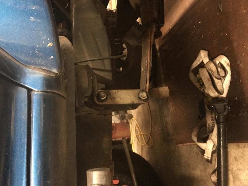

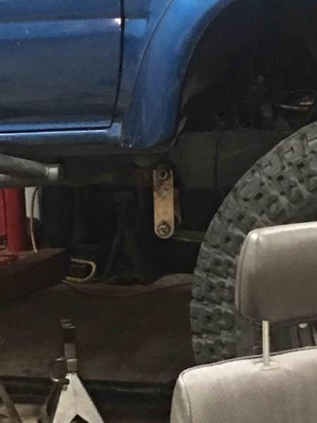

Some more tinkering with the springs not sure I like the shackle angle now ...tranny is done so as soon as it is back in and I can help break these springs in we will see if I buy boomerang shackles or something to help

I'm with choppy shackle angle looks great, it leads to nice predictable flex
I ran my shackles like that for quite awhile with no real issues. When I moved my front axle forward I put more angle on them and prefer that more now.
Seems like my suspension is more live on the front especially with down travel. Thought is the shackle is now moving rather than already being at its down state with the previous setup. Kind of a up travel vs down debate IMO which ever you prefer
Yeah my spring hangar is already pushed forward. We will see how it does once the tranny is back in and I can break them in a little
