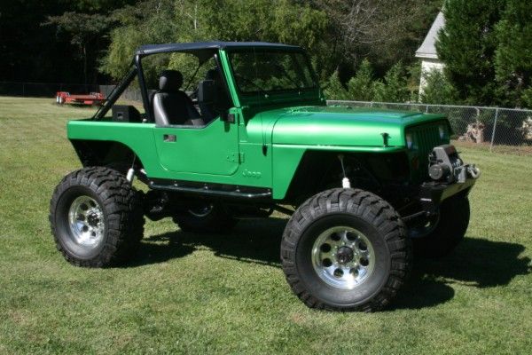

Aw, look it's the crab apple. Probably the biggest heep I,ve ever built. Naw, just kidding. This is really nice jeep,built for a really cool Friend. IT turned out to be a fantastic RIDE.
No weight jack's. Those are the studs that hold the small plates inside the coil spring. It hold the springs on their mounts top and bottom. Hoptis answered your question doctordick. Oh, and I like your WILLIYS WAGON.
HAH.........CRABAPPLE it IS ;D

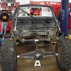

Well its OFFISHUL....the front of the jeep is up on jacks and the leaf springs are GONE :gtfo: ........
Heres some of the parts that will make up the 3-link set up.....
Heres some of the axle mounts tacked in place......
Up next Drews custom built BENDER MOCHINE comes out to bend up the truss for the upper link mount attach point....
Heres some more custm axle bracket fabbin...........
few more pepsis..........
Lower link frame mount beginings...........
and heres how it sits as of now...
