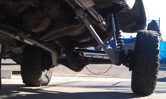

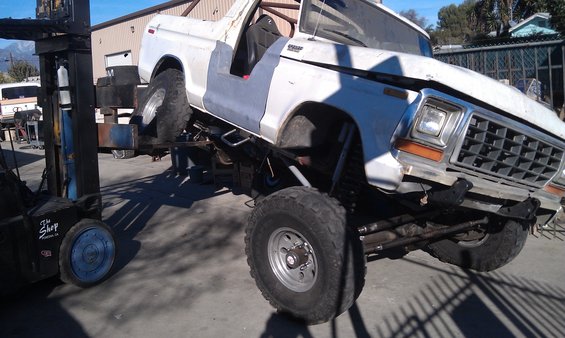

I did get good / enough drop out of the front when it was leaves in the rear.
This is when i first flex tested a few years ago
