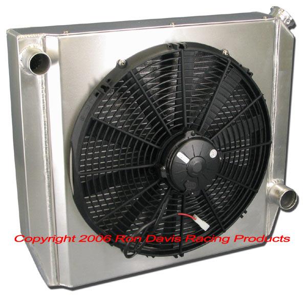

Ron Davis Single Pass Radiator (22x19), with integrated fan and shroud

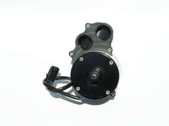

Meziere Electric High Flow WP

First, just to make sure I am installing a new mechanical temp gauge and putting the stock 195 degree t-stat back in. I think that the gauge is definately bad, but I also think that it will still overheat if I push it very hard for long times because my radiator is too small. True fix is a bigger radiator in the back with twin fans, and a mechanical WP in the front. The remote mount electric unit is only there because the 1st owner did not have clearance with the front radiator to mount a regular pump, so he did this. I don't trust the electric pump and think it is part of my problem. So pust up your cooling setups good or bad so we can see what works and does not work for some folks.

your fan on the rear and pulling or pushing? At speeds it sounds like your fan was fighting natural air flow and causing a deadlock if it stayed that fuggin cool on the rocks.
Fan is behind the radiator on the engine side, so it should pull air across it. I checked that when we stopped during the race and it was hard to tell if it was pushing or pulling, felt like it was doing both honestly. It was really hot also though. I will check again when I finish my gauge install.

I don't think the electric water pump is your problem. We have run them for years on mud trucks that are well into the 700 hp range. They are put into abuse heavily going in and out of mud holes. We do however run the pump on the motor instead of like the one you are running.

So I installed a new guage and put the stock 195 tstat in. Also noticed that my WP was not running. blown fuse, and now it is super loud again like it was before it was rebuilt :gay:
It appears my fan is pulling the wrong way also. My radiator is mounted facing fwd, so the fan is on the back side next to the engine. I would assume that the fan should be pulling air from in front of the rig through the rad and not pushing air from the engine compartment back across the rad. I put a piece of paper in front of the radiator and it was being pushed towards the grill. Then I move the paper to the behind the fan and it sucked it down on the fan. This tells me the fan is pushing air from the engine compartment back across the radiator, which is bad.
exactly what I was suggesting, as it only heated up when your speed overtook the fan speed and deadlocked the air.
Yeah, I bet a taurus fan running in the correct direction and a 180 (or even 160) thermostat and you will be golden. thumb.gif
