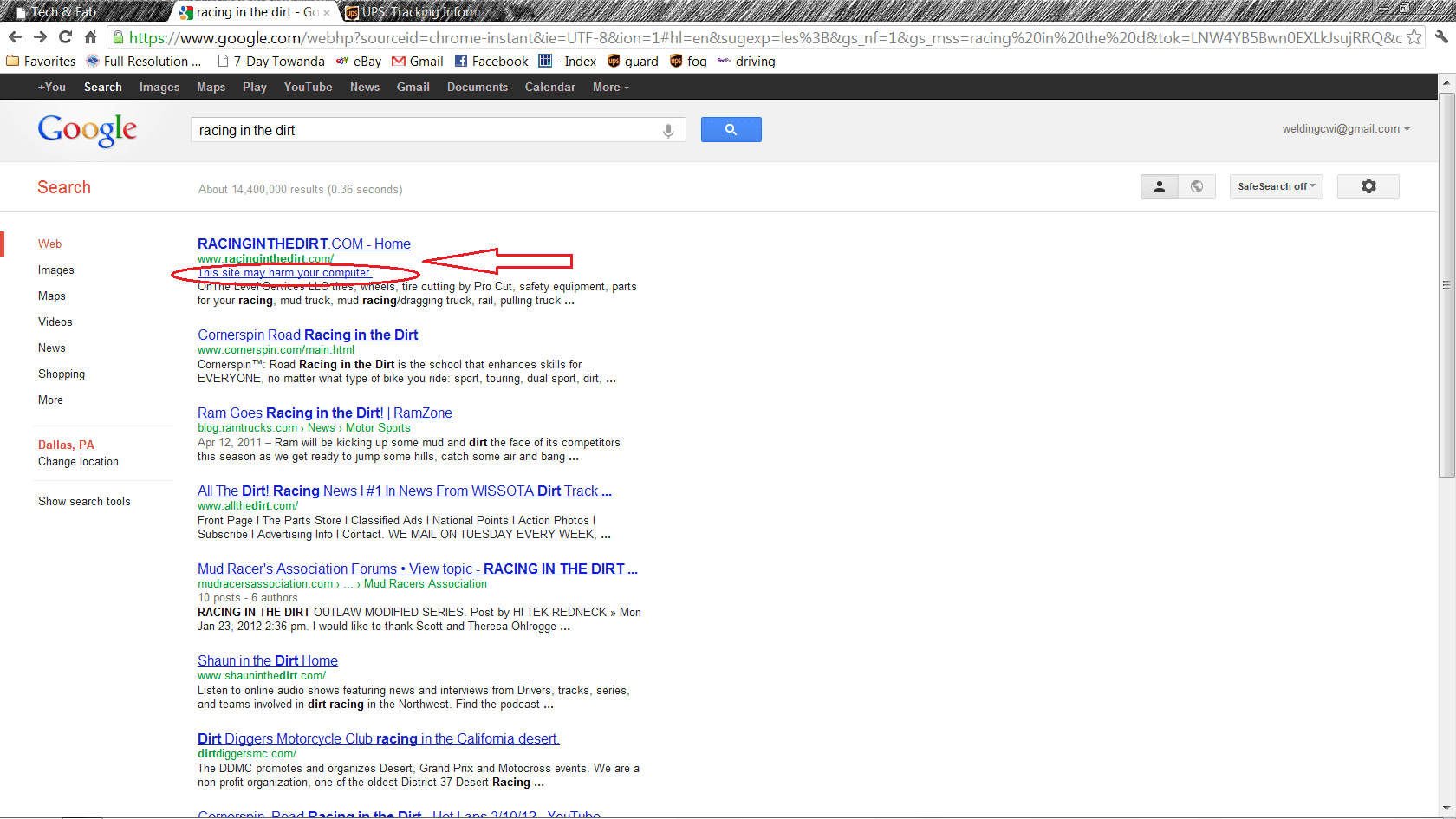

Yeah they are badass, Look up RacingintheDirt.com they make them

Probably nothing..

Probably nothing..
Yeah I noticed that, not sure whats up with there site. You can see the Hubs and brakes in the Hitman Build thread on here.
