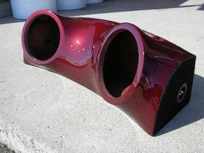

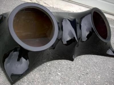

But even something simple like this. With the utility drawer in front still..
I like that the Jeep one has the Jeep in raised lettering. Kinda cool.

that is some good prices. When I worked in the industry we charged that just for ones done in carpet and twice that for paint just becuase of the amount sanding required.
Nice pics Mrs. Crash.
It is so amazing to see some of the things people build from fiberglass. Since my company specializes in fiberglass spray equipment I get to see these type of things out in the fields, things from yachts, hot tubs, hovercrafts, speaker boxes, wind mill blades etc.
those prices i was just guessing for someone to do on the side not for an actual shop to do it. an actual shop will rape you for something like that.
yeah for the boxes its pretty decent. I wonder what the shipping is though lol :redneck:
Oh the lettering it's actually pretty easy to do. When your laying the resin you layer in the lettering then cover it with more grill cloth and it will give the relief of raised letters.

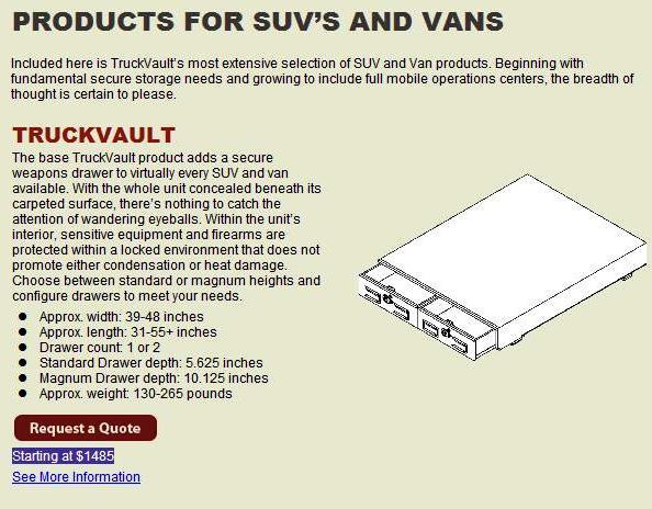

Truth is I don't know what I want yet. Which is why I'm throwing this out there. So I can get ideas. I just know I want it to look natural and not cheap.
Holy cow. The basic one isn't even a little cheap:eeek: But it's basically what I want.
ya Mine cost $833.97 14 years ago. It has been in seven different work trucks and I use it every day, so for me it was worth it. Broke a key off in one of the locks a couple of years ago and they replaced both locks for free.
Oh it may very well be worth it. I just have a feeling I could have one built a little cheaper. Same idea though. But if not, It may be worth the cost.
