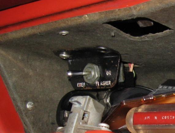

So earlier in the thread I had mentioned I had no idea the switch in the glove box was for the 4 way flashers(was just resting in it). Well after that bit of reasearch I "thought" the switch was mounted to the metal portion of the glove box lip. Well I was digging thru a few boxes of misc stuff my dad had gotten when he bought the car and I found this.
From my understanding and reading 66' was the one year where the switch is hardwired to the harness and replacements were a blade style switch. Well I found this bezel with a blade style switch on it so there is a spare. The other thing I finally figured out is the fact the switch bezel actually mounts to the carboard glovebox insert--odd. In any case when I get the replacement insert I can install it correctly now.
Yes, it's like that in my 67 F100. It uses screws/nuts and has a little thin metal bar on the top side to back the cardboard liner.

lol....times 3....When I got my 69 F250 it had that style of switch in the glovebox but the switch was no good... I grabbed the later style 70+ push/pull switch that goes in the dash and matches the knobs out of a parts truck and swapped it in.The harness was the same and now the knob in the glovebox is pretty....but the best of all is that the flashers actually work..lol...
