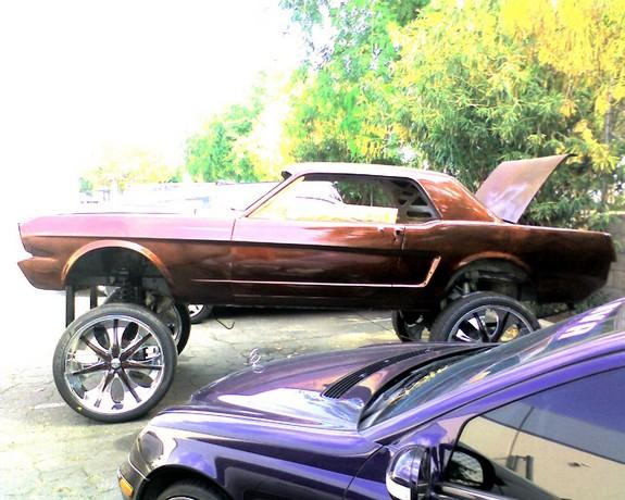

Mike love the stang. the light pictured above is what my mustang has.
as for rims i liked the 67 cobra style stock mags... like were on Elinor.:D

i just remembered your dads mustang is 4 bolt on the rims. very limited options out there.
maybe best to just get some of the wire hubcap/covers that were stock in the day. mostly came on the Special editions. convertables....calif spec etc

I have a very nice set of stock hubcaps....
