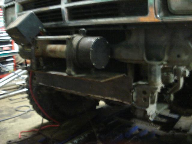

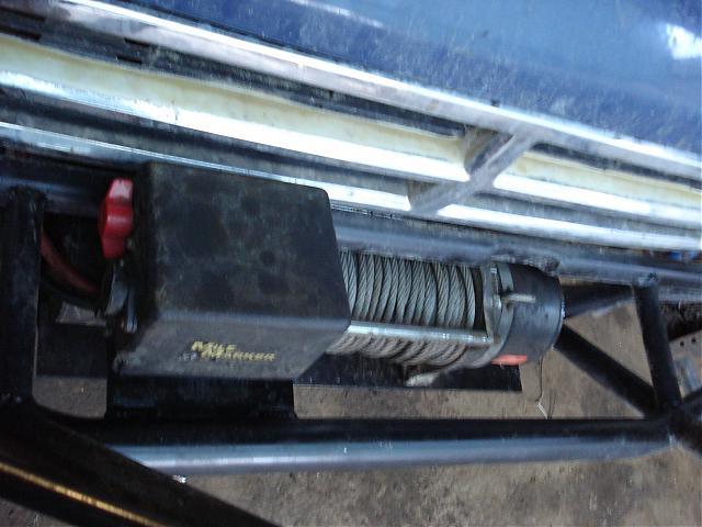

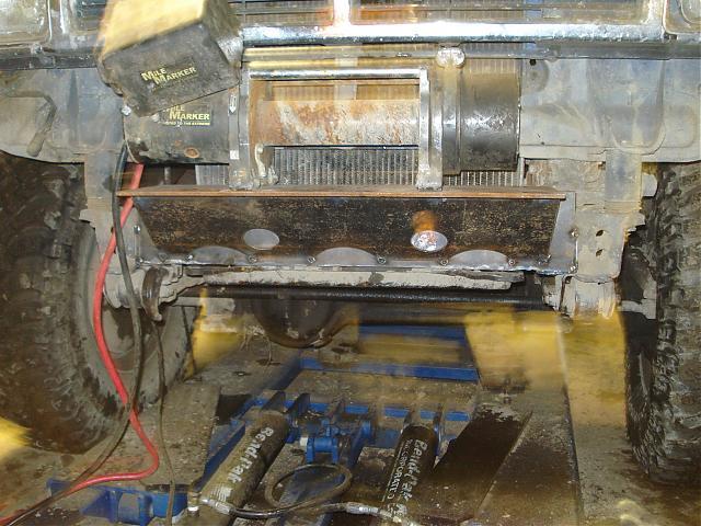

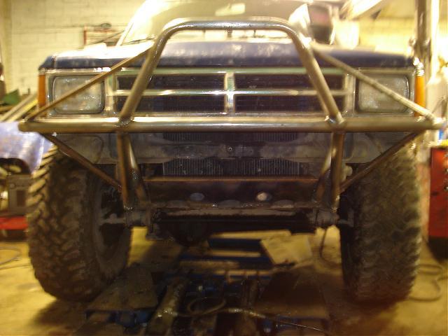

got the bumper/winch started
sum pics:beer:

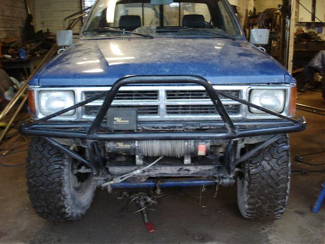

rest of front bumper

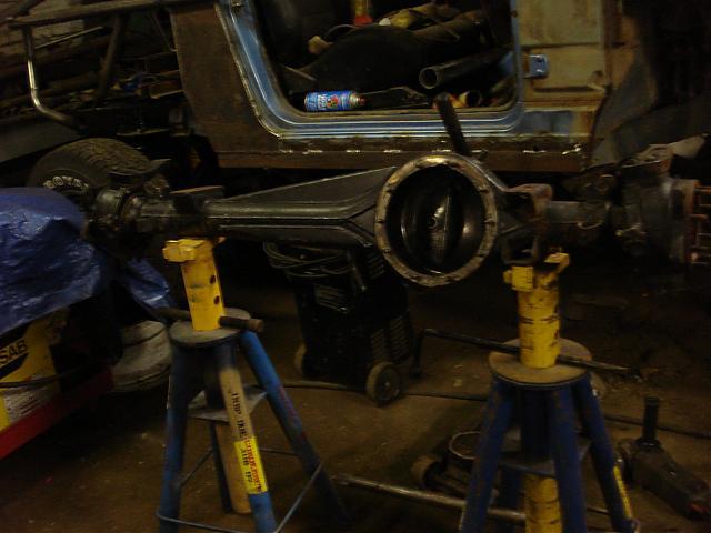

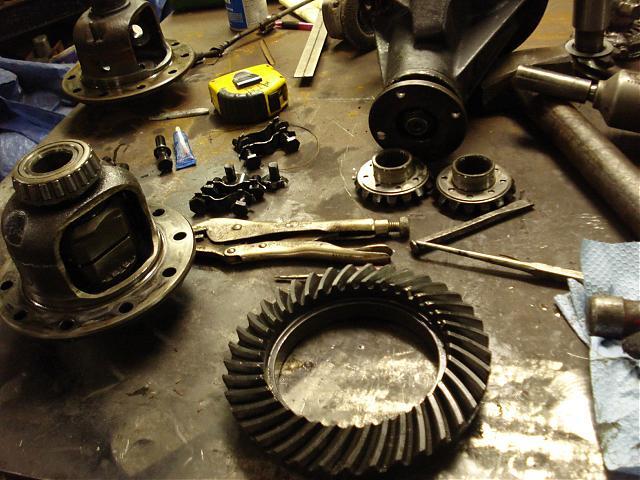

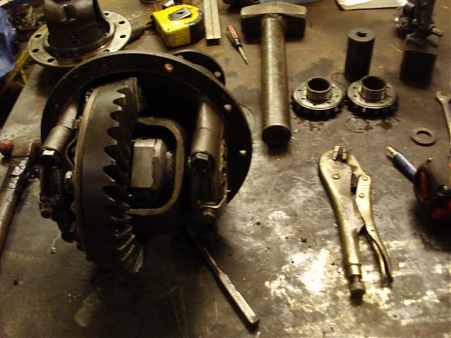

Started on the front axle today. My old fornt is kinda tired, so I figured Id just put a complete front together and just swap it out.
Setup the 5.29s with a solid pinion spacer and a locker for the front. front housing has new kingpin bearings and a sweet truss.

the bearings you referd to as kingpen bearings are known as trunion bearings:beer:

PS, you do realize that your bumper is not street legal. Be prepared to get dinged for that. It looks great, but it doesn't meet the 4.5" frontal surface that's required.
I busted that right front steering arm off about 5 times before I finally gave up. The 5th stud upgrade is a MUST with lockers and big tires.
Evans will be the only problem. Any where else he will be ok. The enumclaw area is the worst for getting tickets for modified street vehicles. Looks good Brad......keep up the good work.

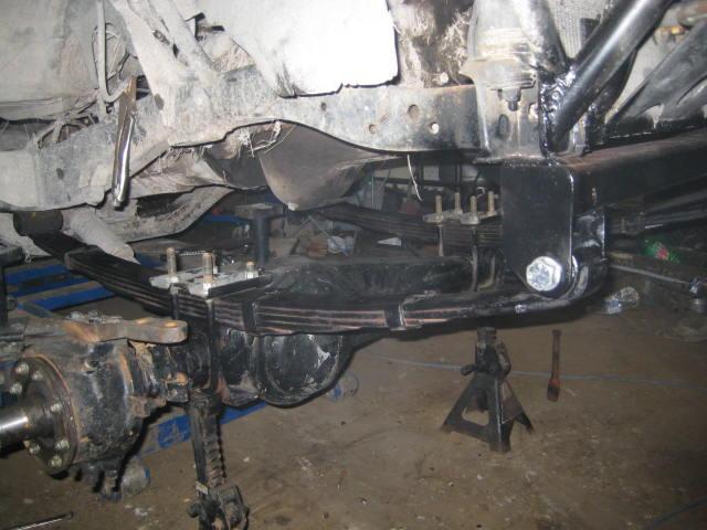

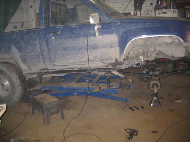

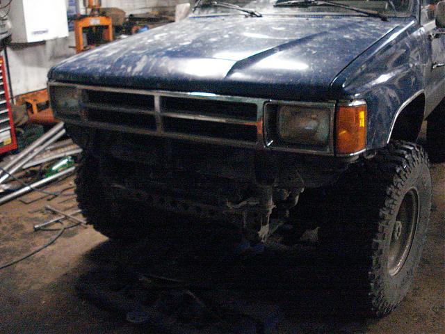

Got the front end in today.:D
I put a beam in front to move the front foward a couple inches. I put some rear chev bushings in the springs and with no sleve it fits a toyota spring bolt perfect. A ubolt flip compliments things nicely. The chevy springs moved the front axle foward 2 inches, perfect.
It sits about 2-3 inches taller in the front than the rear. it was stock, no lift when I pulled it in today. It should sit perfect with the 63s in the rear.:beer:

What did you pull the front springs out of???
I like the front bumper...:awesomework:
PullaPart in tacoma, $11.50 each came off of a blazer, they had some god awful tweaker yellow paint on them. got a flow master off of the same rig for $6!:awesomework:
Thanks, I was gonna do the bumper a little differently this time, but everybody can ID a truck I did by the bumper. Didnt want to dissapoint.:awesomework:

Aren't the front springs from a K5 48" long???
they measure 45.5 eye to eye with no weight on them. I had two sets of springs, one pair from a 67-72, and these for a 73 up. I did alot of measuring the other day!:eeek:
Its going to ride firm, not flex much. I didnt want it to flex much up front, I just didnt want to buy long shocks, deal with tierod overlap, front slipyoke falling out, bumpsteer, etc. So many problems pop up when big travel is the goal.
With it being locked up at both ends it will go eveywhere I need it to go and it will still handle GREAT when my girl is pimping it around town! It will mostly see snow, sand, mud, moderate trails. Its a purpose built machine, being EXTREME is not its purpose:cheer: plus the rear will flex pretty good with no real downfall other than the cab following the front axle.
