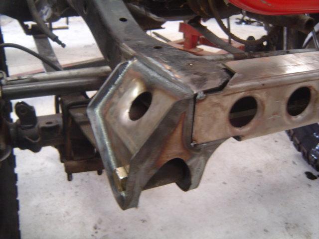

I've used them. Cut out the holes for my gauges and then dimpled them and now the gauges sit flus with the dash. Also dimple pieces of sheet metal and patch the area where my cage comes through the cab.

My boss tought me how to make dimple dies like that and am amazed at how expensive they are as it is very little time on a manual lathe and most of those are made on a cnc lathe that prob spits them out in 15 mins a pop if that. Just never looked at how pricey those dang things are.
Theres another technique for forming sheet metal thats pretty cool. You can use a cnc mill with a ball instead of a cutter. Clamp the sheet over a hole of apropriate size, program the head to move around in a circle and move slowly into the material forming a depression, then cut out the center.

Fawking engineers..:flipoff: I am gonna copy a set here soon and get my shop to start making them. From mild steel d-dies to chromo dies that are heat treated..I just need to borrow a set so i can measure them.

If I can get mine back from Mighty...maybe I could see my way clear to lend them to you for this ...Bunk get with some of your engineers...I would like to get a heavy duty set that would do upto 1/8'' (.125) right now this set is good upto 16ga....so I could lend em for a great deal on a HD set????

I would think the dies for .125 are chromo, I think im just gonna buy a set from poly and go from there.
