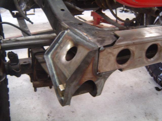

pokey said:
OK for us fab illiterate guys:rolleyes: just what do they do? Pics would be good:clappy:
Allows ya to make stuff lighter but just as strong. Drill a hole, Insert the proper size die and put it on a press and go to town..Heres what it looks like once done.
Thanks, Thats kind of what I thought but wasnt quite sure. I assume by doing that the steel stays stronger around the hole by creating the "lip"
