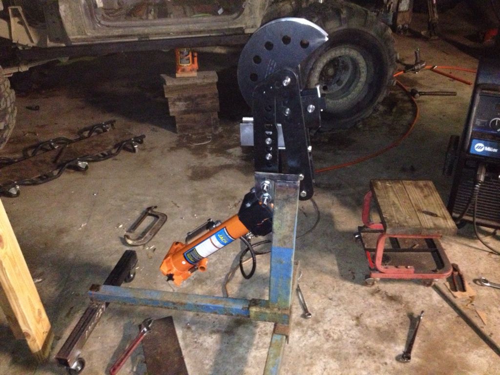

Vertical is the way to go. I talked to Jay for about an hour befor I made my decision. I used an old engine stand and put 50lbs of weights up front http://i1271.photobucket.com/albums/jj637/whitwilliams74/5EF0839B-08C1-4E48-AB79-57B25B598A1A-2283-0000036D11D6AD99.jpg
Looks like you are making good progress with it too. :dblthumb:
