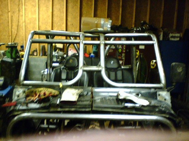

Doing a little work on the HEEP

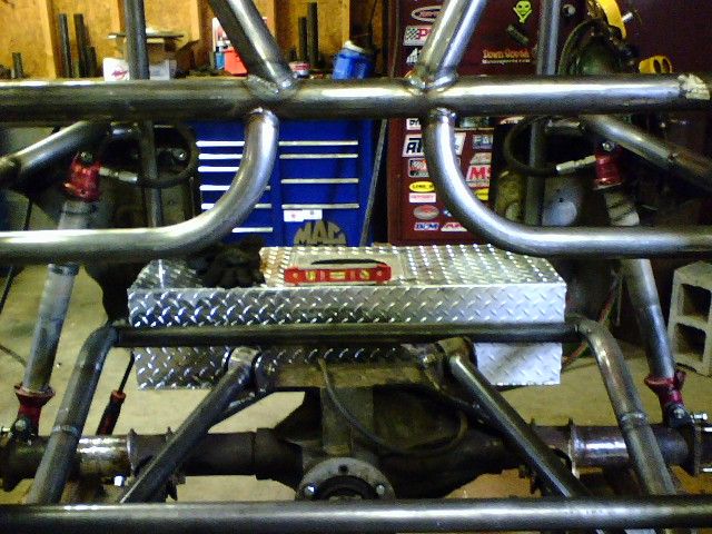

Ive also welded up the back of the TH400 hope it wont brake
JUNK cell phone pic but it works

Payne welding the rib area wil keep that area from breaking, but it will break where it starts to neck down to the ribs if the trans and t-case are not supported correctly.
Ive seen 400 done like mine b4 they had ran them 4 a long time with out brakin so that y i done mine that way it better than stock

definitely better than stock and wasn't doggin it. Just sayin it will break right before it if it is not "mounted/supported correctly"
