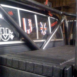

couple pics of my runner don't have any current with the 37's but you can get a good idea of what im doing with mine and how it sits
note these tires are 37x13.5x17 wheels are 9x17 4.25 BS
i am now running 17x10 4in BS wheels and still no rubbing
i had to notch my fire wall all the way to the body mount. if i hit it hard enough it will rub very slightly on the smooth surface which is not an issue
