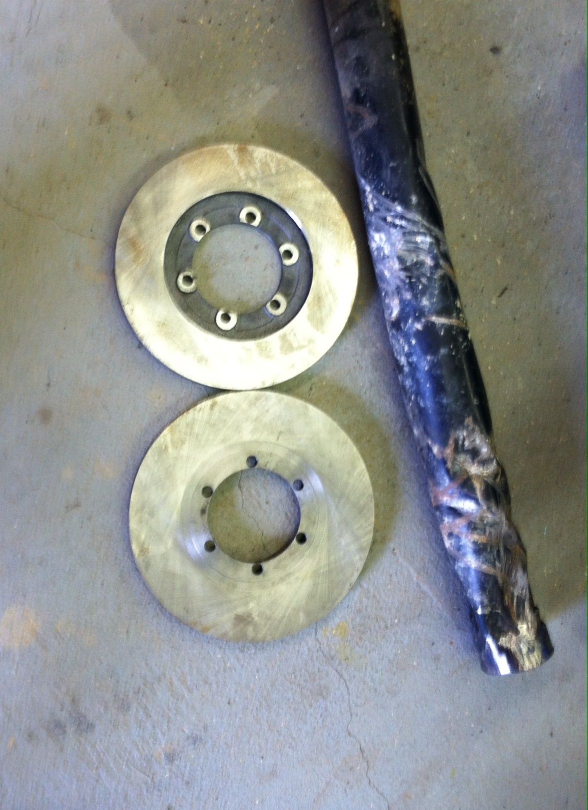

Got two new rotors back from machine shop

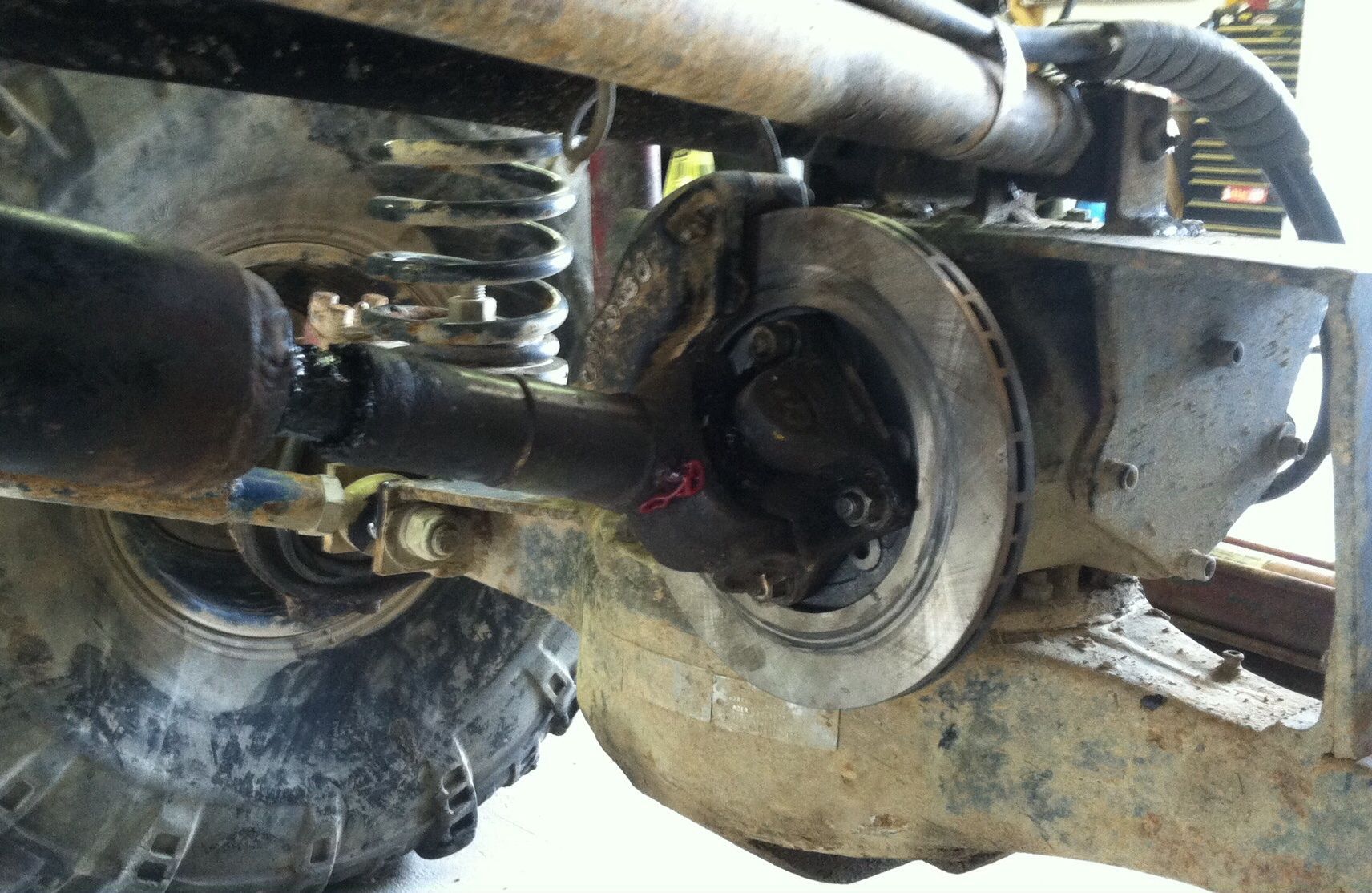

One thing I have never understood is why so many people build/install driveshafts that mount the slip yoke at the pinion flange?
I do it sometimes because you get one duce driveshaft and cut it in half, then cut ther other one ton shaft ( or whatever your using) and you can make both shafts for your rig
exactly right and it works and has worked for years so don't be throwing off on my **** buddy :gtfo:
Re: Driveline
Ok maybe I'll re phrase it. Not raggin on your setup. I was curious why the "thing" to do is mount it in that orientation. I picture rocks beatin the snot out of that yoke and sleeve plus sometimes the whole weight of the rig resting on that yoke. Wearing the splines out on the shaft etc..
Just wondering
Just wondering
its cool man. I have just ran it that way because it's what I had lying around but I'll swap ends with it on my new shaft :dblthumb:
Re: Driveline
No worries. I know the KOH guys run them that way so if they break a rear joint they only have to carry a yoke. In all honesty it may be the best way
if you're going to be so ill fc john g may ban you...lol
