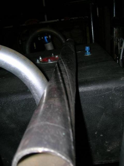

This was 2" schedule 40. Tires didnt even move when this happened. It was a mixture of compound low and the fact i have 4.10 gears on 40's and those huge 1 ton 14bolt brakes doing there job holding the tire from spinning. Took me three times of building new drivelines to realize that i should stop trying to power brake it on dry concrete in compound low. The carnage sure was cool though.:redneck:
