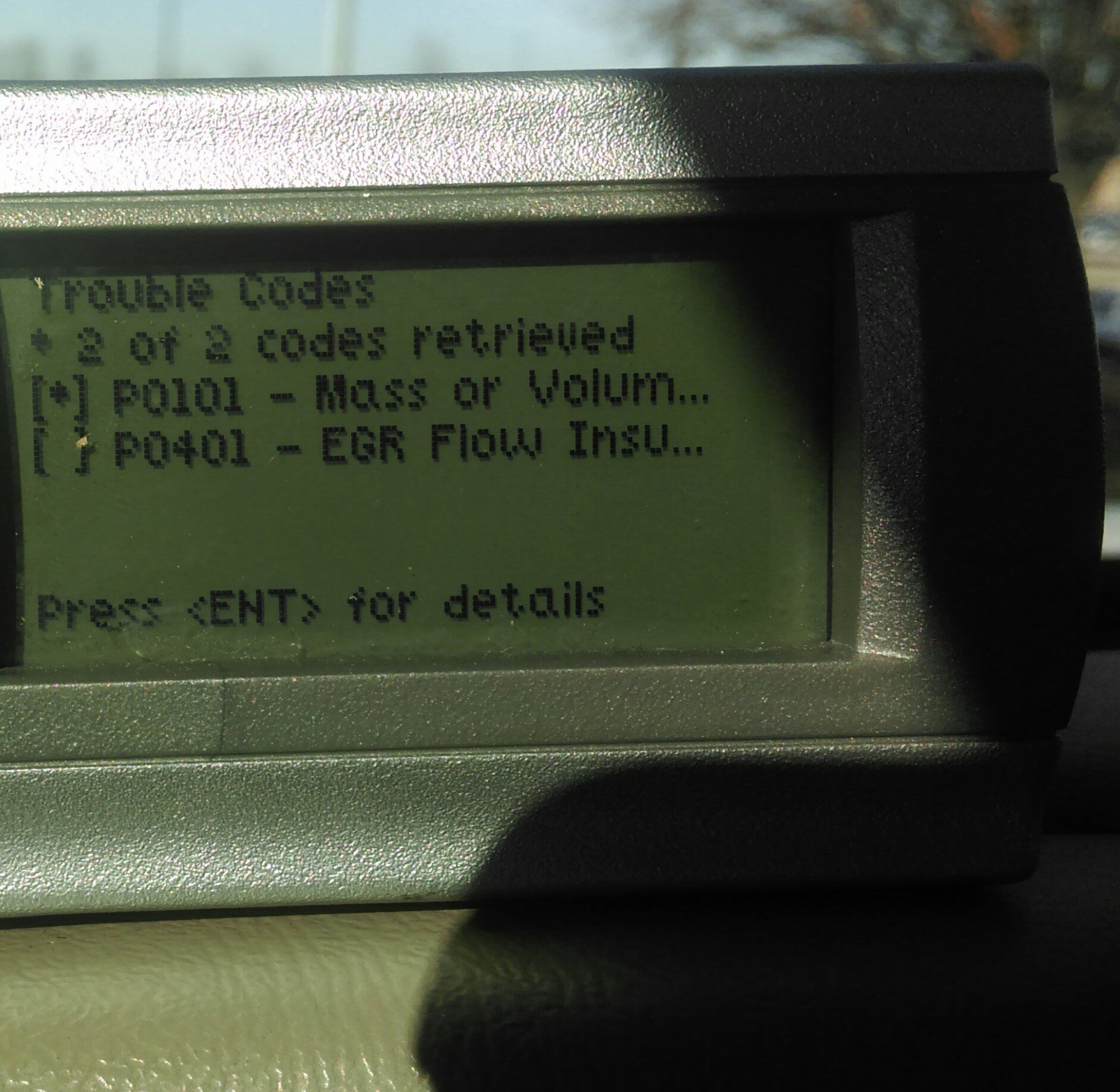

Re: Duramax head gaskets???
Got this today right after turning to stock.

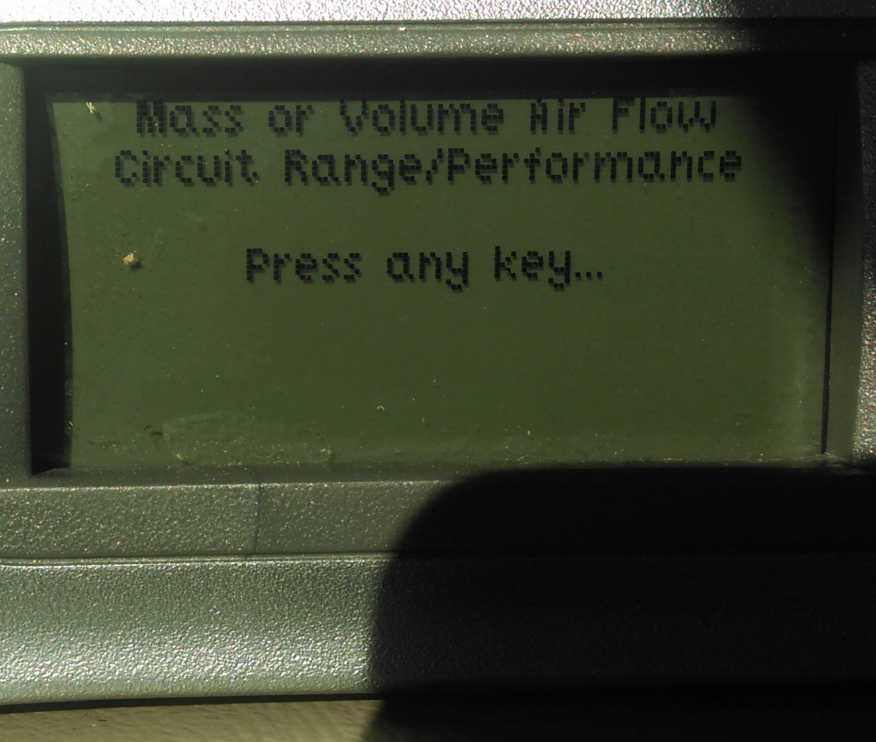

Details....
Egr can put exhaust pressure into the coolant if the cooler cracks internally. If this has happened you will also get coolant into the engine when the Egr valve cycles. Best thing to do is pull the Egr valve and see if there is any water or traces of water around the valve and cooler outlet. Best way to check is to pull the intake tube off and unbolt the valve from the cooler then unbolt valve from the intake horn hope that helps as far as your codes it sounds like harness rub on the intake horn

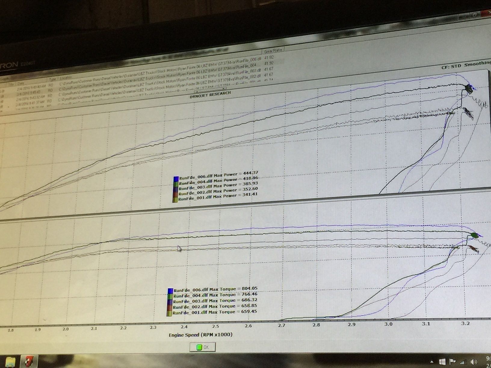

I got the truck back last night. Again, it was a very small head gasket leak. Just wanted to close this thread so if anyone sees it they know what the outcome was. It ended up with some other mods along the way that I didn't intend on, but I think after driving it home last night, I'm happy I pulled the trigger. I guess the real test will be the trip to HPO for the Hardline ride. Anxious to see how it pulls now.
Here is the list of mods incase anyone cares and the dyno sheet. Leaving power on the table due to running a stock transmission, but I had no intentions of modifying this truck at all when I bought it. Starting to look like this could be as bad a habit as wheeling!
