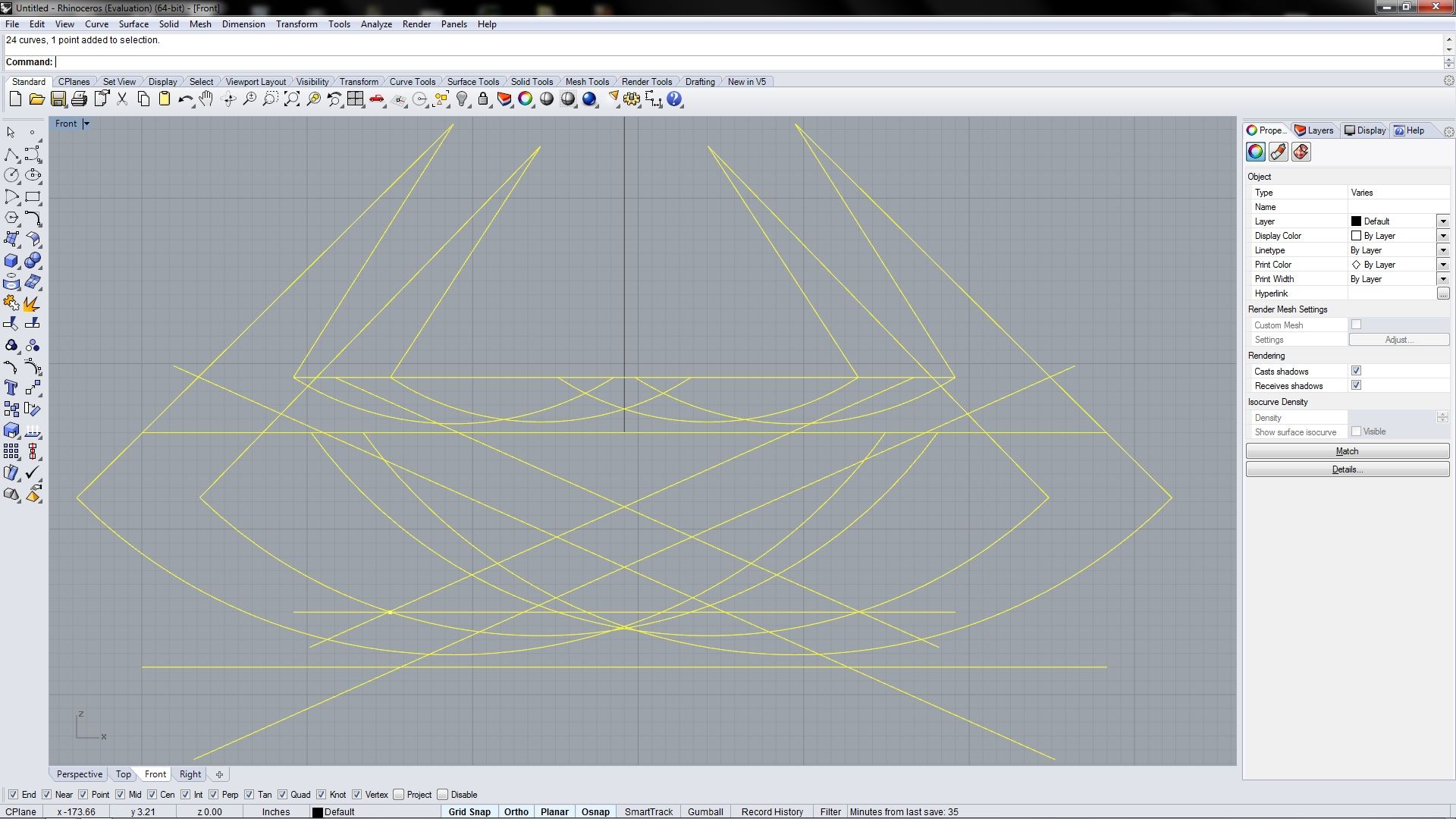

Went with some 6 inch backspace wheels, judging by the known 12 inch tire patch. Scrub radius should be down around 1 - 1.5 inches. Should keep the power steering pump lively, and reliable.
I want to set the springs up as close this configuration as possible so I can send the force of my springs to the center of the tire patch that is needing traction during the course of a turn. Most especially the quick, hard dig out turns that always seem to be here, there and everywhere. It will help with body roll, and Adam should be able to floorboard and dig before the apex. Also, this will give me constant force on 17 inches of direct vertical travel. It will give the 4 link more side to side control and the heim joints, more reliability. This set up should give me everything I want. We will have more articulation than needed, but will limit the articulation with limit straps when we need to, or we can run them out for straight up rock races.

Yeah, pretty vague looking, but I should probably only spend as much time as I need on the computer to figure something out.
I don't know what everyone else is thinking, but I know I would never even start the project trying to figure out all that computer stuff out.. That has to take a **** Ton of time.. :****:
A day on a computer could save you weeks in the shop. Computer stuff is why Shannon Campbell can build **** in a week. If you have it all figured out and brackets already lazered out you can roll on with it.I have knocked a week off of what it use to take me to build a roller just by doing this.

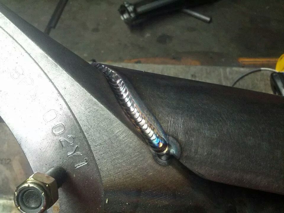

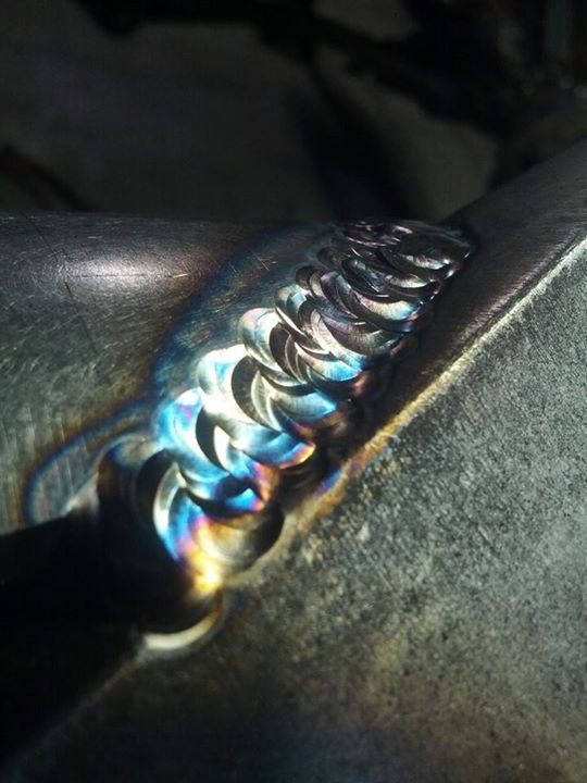

Good gracious. This new welder is like sex :****:

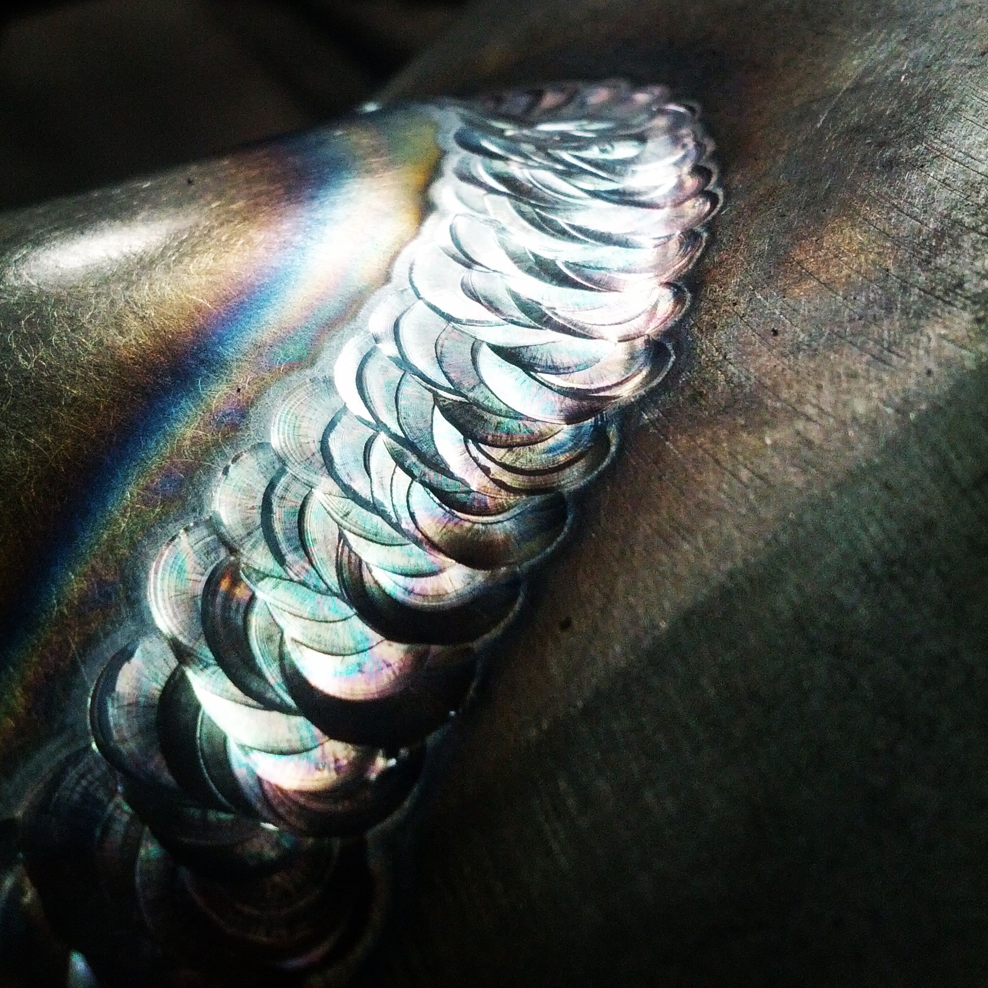

Should get better, after I learn what all the buttons do.

Very good choice of welder. You can fine tune it to do anything you want.
I had the same thought even though I'd only ever used dynasty's. Can't say I knew much about what I was going after back then though. Didn't really know how to use them.
This one isn't as modern, but I know I can make this dinosaur do work. I can already weld tubing just as fast, as my mig welder. No clean up time. I'm totally amazed and curious with the pulse settings. Looking forward to getting to know this ole blue.
