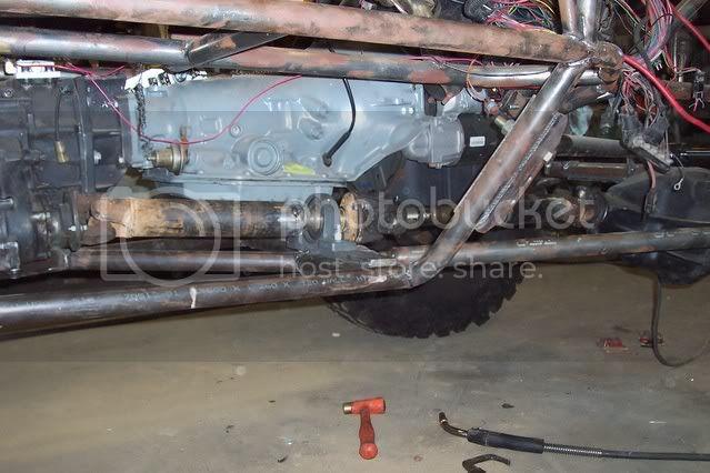

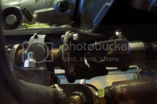

P, I welded a 1350 the the end of the shaft that goes from the pillow block to the axle (Dana60). If you look close in the pics you can see. Yes Jesse sells the yokes I think they were round a bill for the Dana 60 and somewhere close to $280 for a 14B to toy flange :eek:

pillow block thread on pirate right now, scott ellinger welded a 14b yoke and pinion into the tube of a shaft to run the pillow block on. if you have a junker 14b around, cut the pinion shaft off and do this. slip it into the tube and rock out. or 60 front if you want 1310.
In those pics, is the shaft from Tcase through pillowblock permanetly attached to the pillow block ? It appears that it was fitted then welded into place when the lower portion and the upper part of that shaft were welded together ? Or is that flange at the bottom removable so it will come out of the pillow block ?

No it comes off. The flange closest to the pillow block is splined and held on with a nut. The the nut off, knock the flange off, and pull the pillow block off. The shaft has a few step downs on it. Just weld up the areas where the steps are then chuck it in a lathe and turn it down so that the area where the bearing will ride in is all the same diameter.
