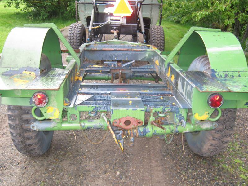

So I got this 1942 generator military trailer to haul the boulders to the trail. It needs some work but I should be able to have it done for next weekend. The plan is to make a deck and ramps and winch the rock onto it, then dump the boulders next to the trail where an excavator can put them in place.
I have the material sitting at my house for the bed. Get on up here with that thing.:awesomework:
I was going to finish the sled but this I think will be much more efficient. We can probably mount what I started right on that bed. I grabbed a couple of hinges today to make the rear gate with. I'd say that in about 2 hours the bed could be finished.

For the trailer I need two sheets of 1/4" plate: 34.5" x 82.5", two big greasable snatch blocks and some square tubing to reinforce the removable ramp and build the a-frame on the tongue. It will be pretty simple. I am going to cut the rear winch cable down to the length I need and 3/4 of a layer on the drum so it will have lots of pulling power.
