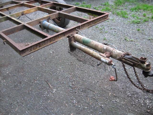

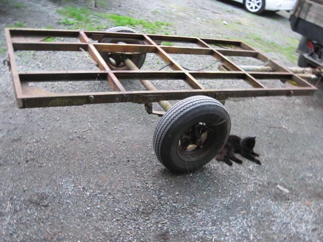

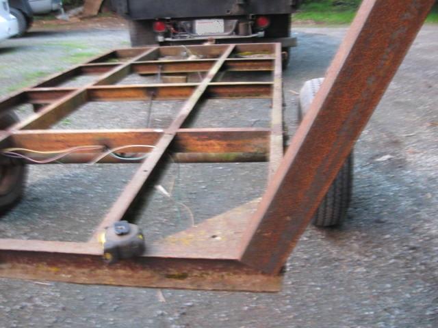

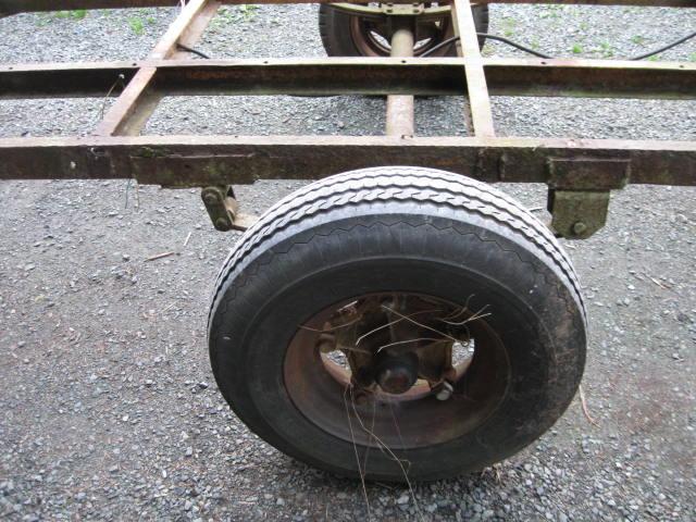

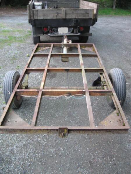

The deck/frame is 4.5 feet wide and 9.5 feet long. It is 6.5 feet from out side of tire to outside of tire. 3 inch channel iron and 4 inch pipe tongue.

In that last pic you can see me holding a chunk of 3x3 angle up at an angle. I have a bunch of 4 foot chunks of 3x3 to cut in half. That will give me the uprights for the side of the box. Im going to angle them out like in the last pic enough to cover the tire making a nice rubrail so trees/stumps wont catch the tire. Then I can make a small nerf down lower closer to the centerline of the axle to make sure the tires slide by stuff nicely.
