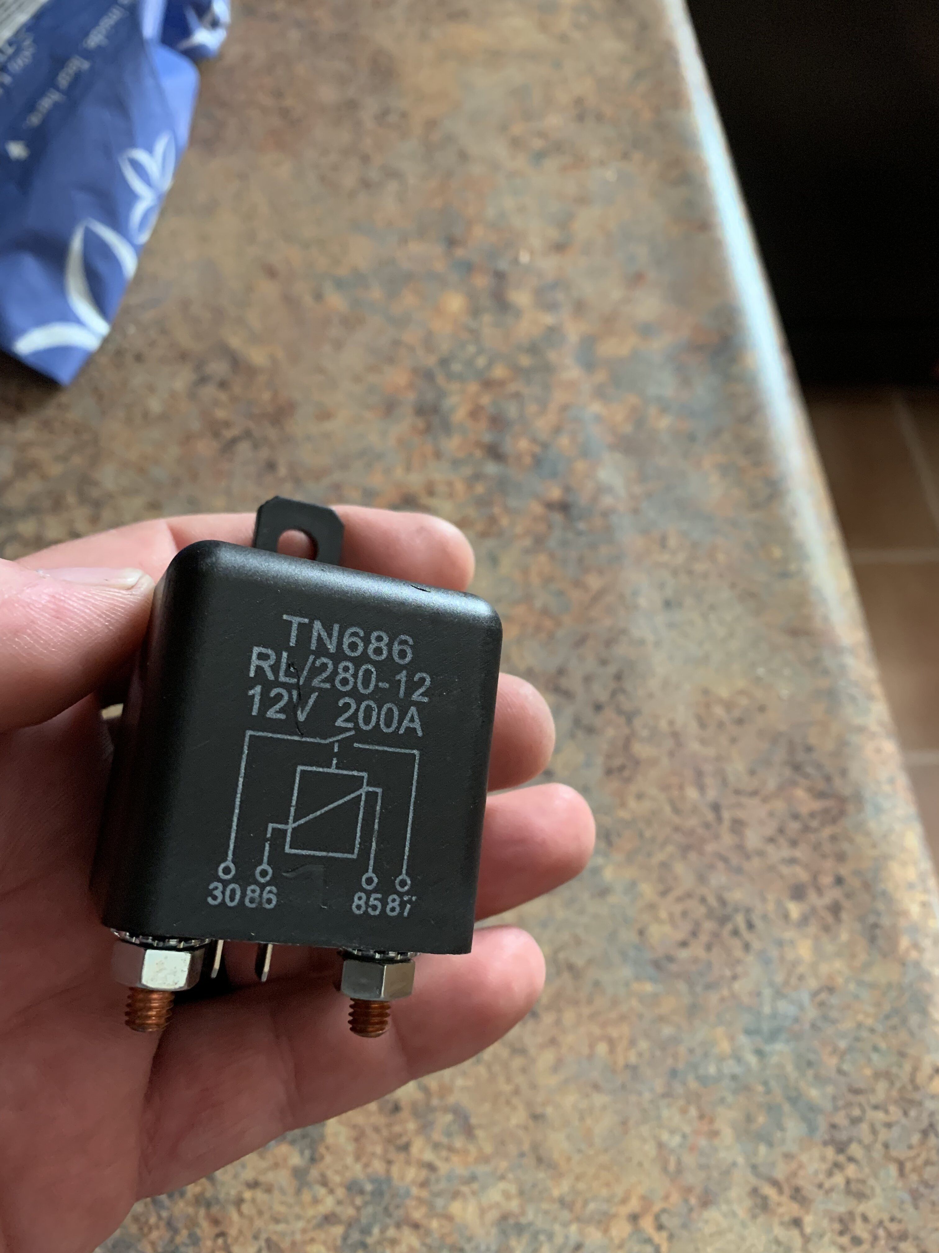

The big red wire and the single unstranded wire need to see 12v plus the ground. I'm going to put it on a relay. In the barn turning the wheel I can hear the pump spinning faster and pulling more amps. 100amp relay probably would have been enough lol
