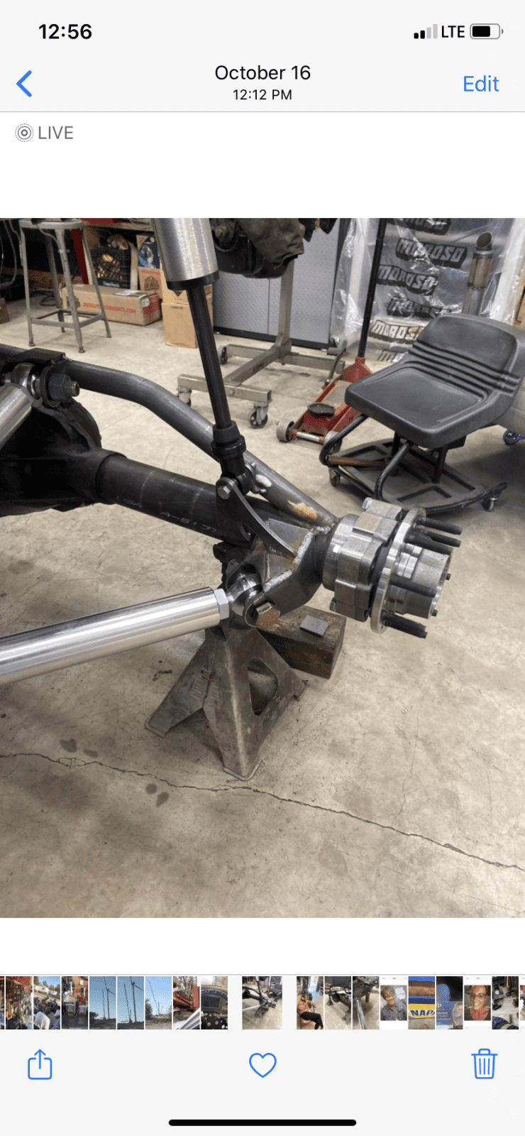

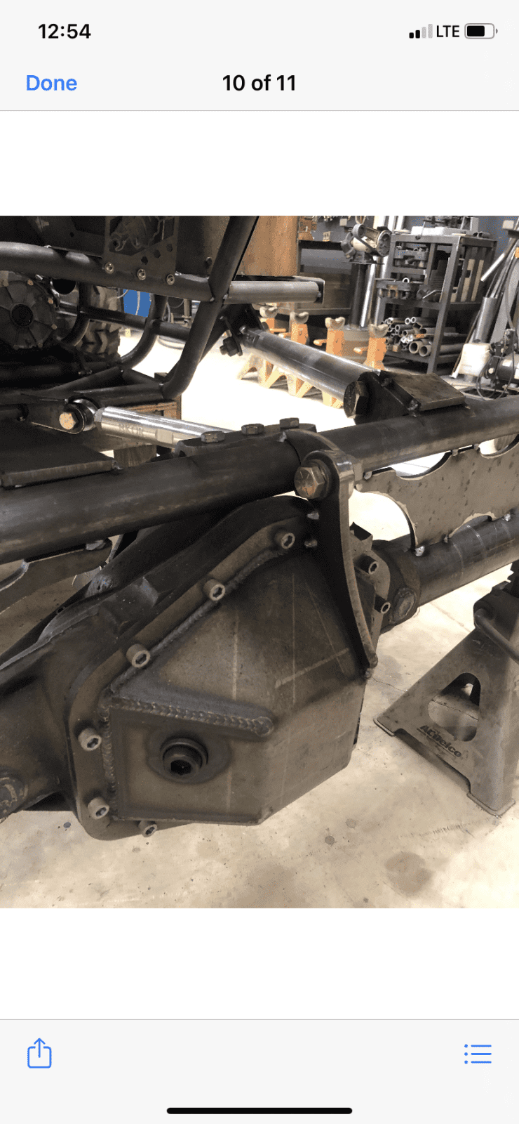

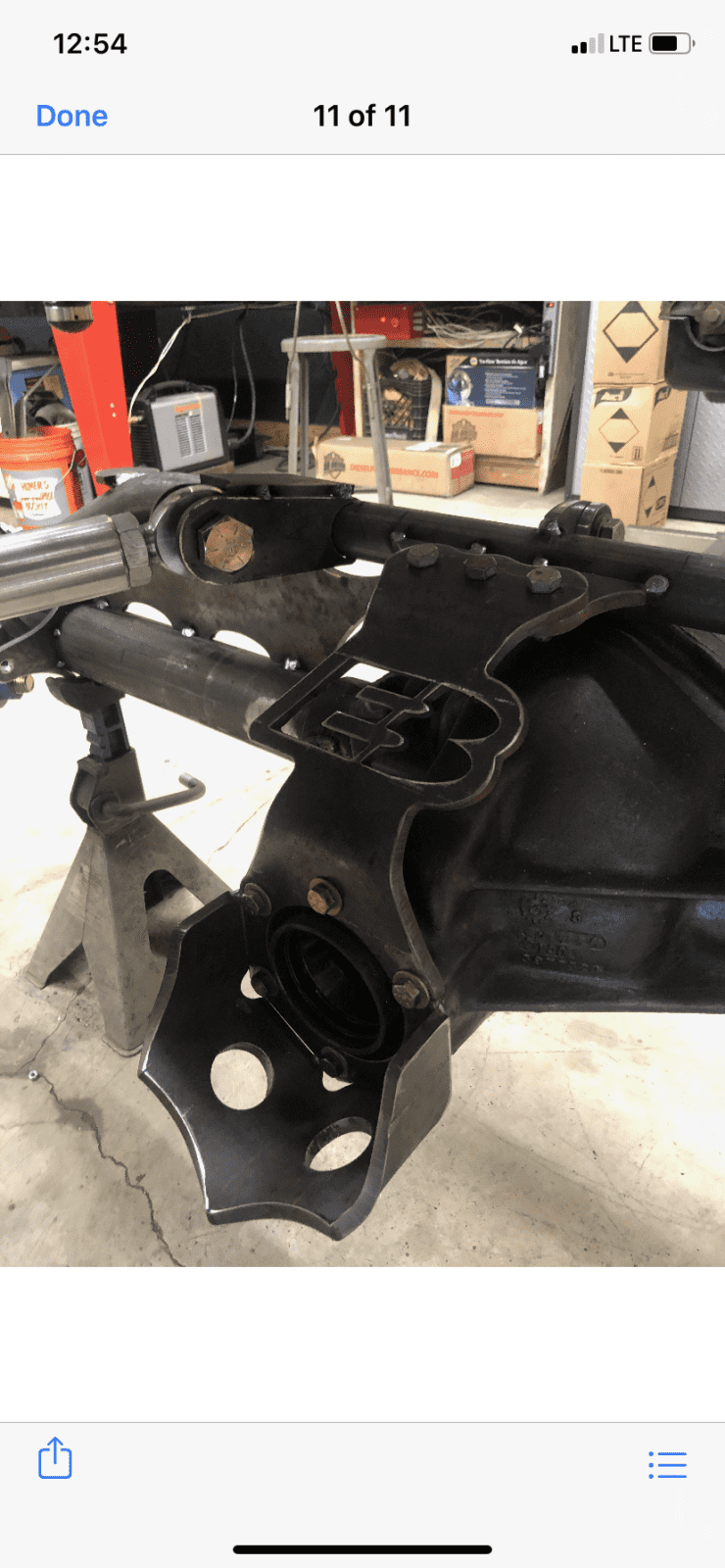

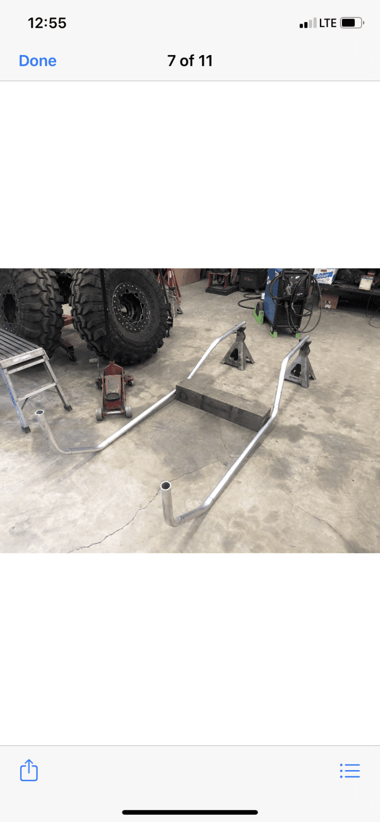

Stephen is almost finished with the small detail. Then to my shop for weld out and final assembly. The aluminum tubes will be attached to the frame rails for coolant Radiator to engine

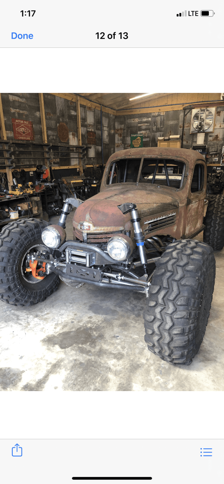

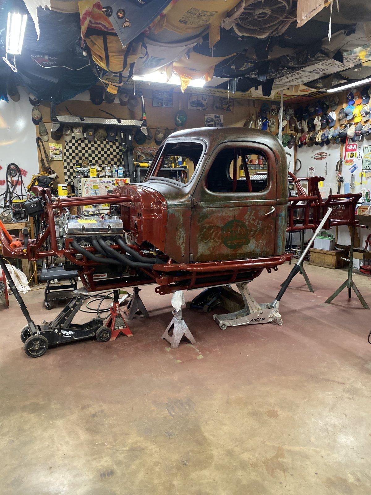

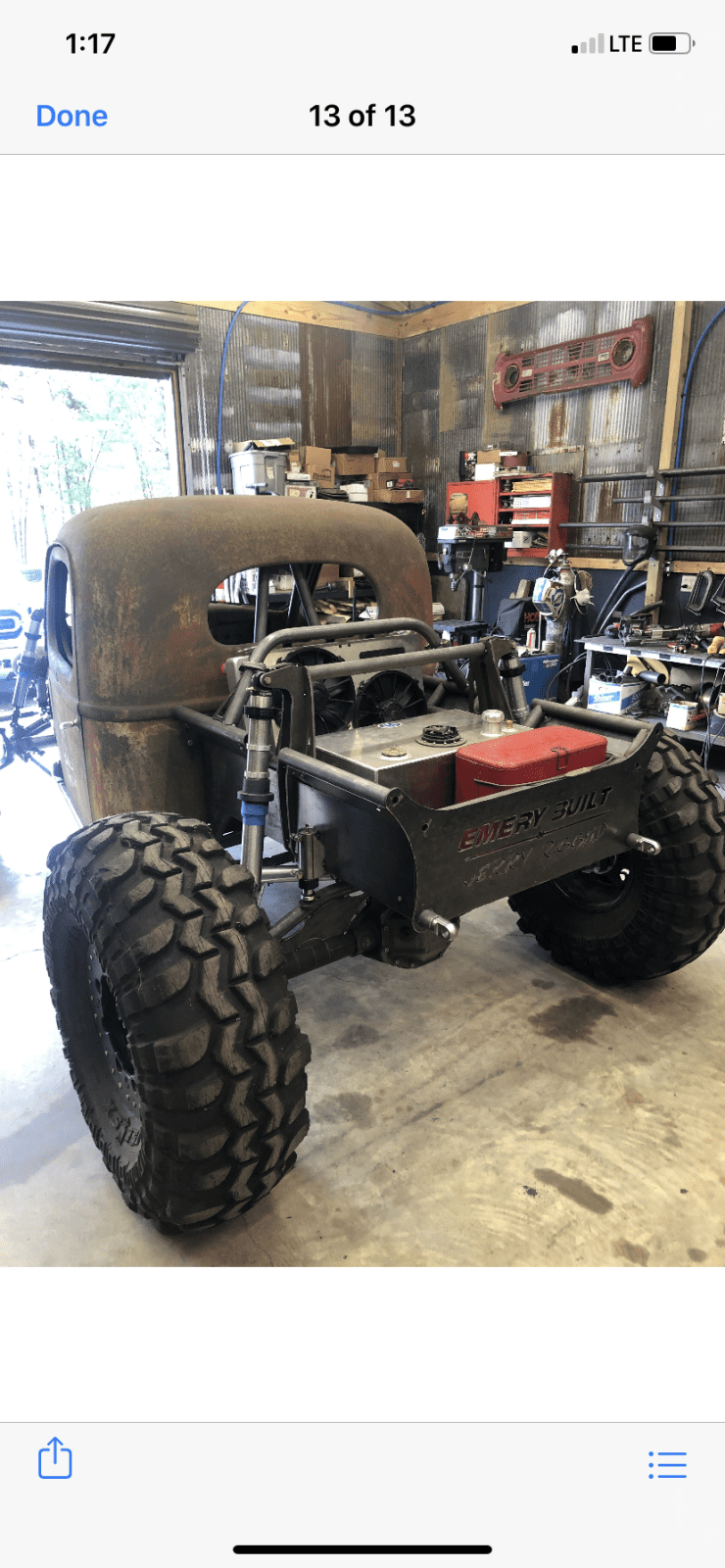

man this is such a cool rig overall. Some really good details and ideas used throughout. I would shamelessly copy things off of it in a heartbeat.
Very cool. One of the best parts of this hobby, building something that is unique and still high performance functional
We have it sitting on the bumps right now cause I haven't scaled it to figure spring rates. I think it's 20" to the belly

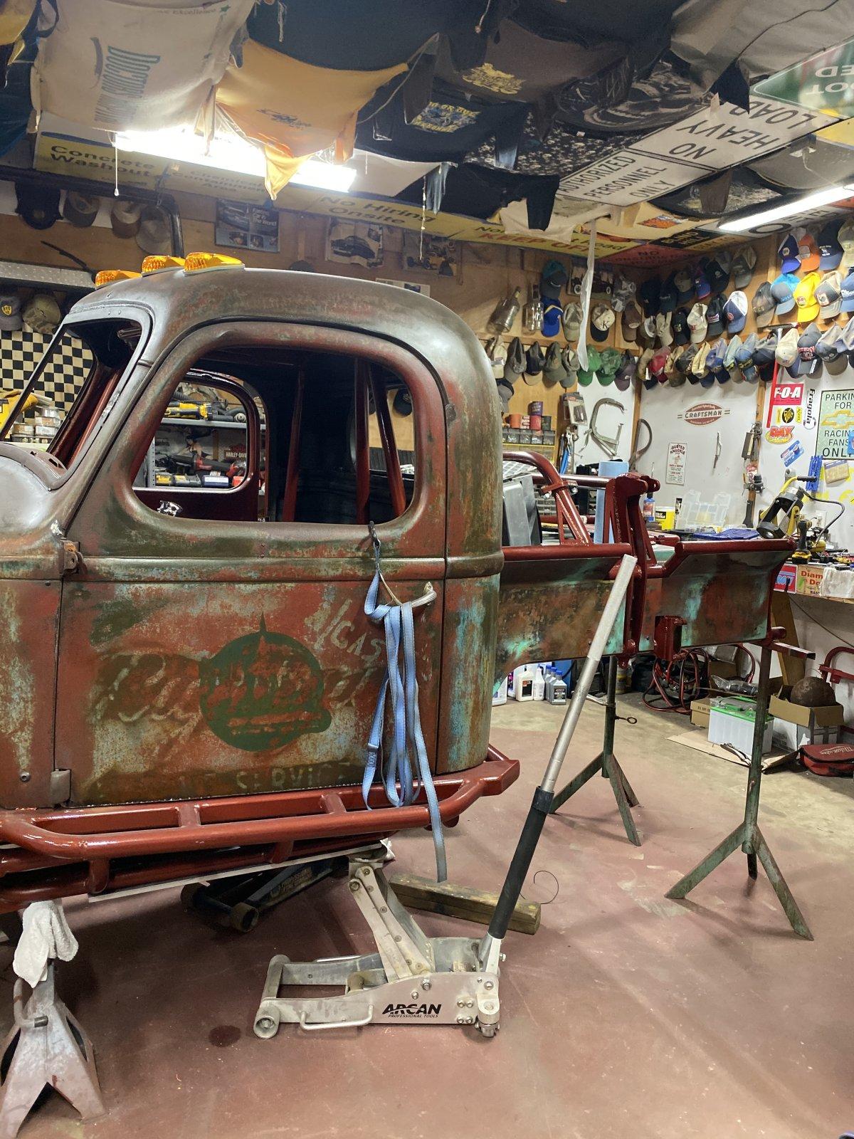

Did you clear coat it or use the patina wax or whatever it is? I saw the wax get used on Hardcore Fab's Hooker and Blow.
I used boil linseed oil. Takes it a couple days to dry. I've used penatrol on other patina works good to
10-4, have to admit I would not have thought to go that direction. I know to use linseed oil on tool handles etc never would have connected the dots to use it in your application.
Used it on several rat rods. Worked good

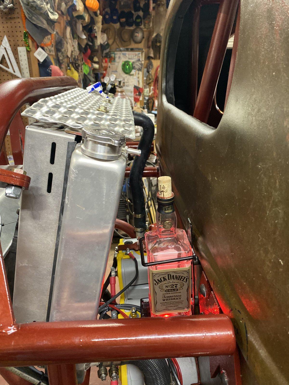

Custom overflow and patina match bed panels
