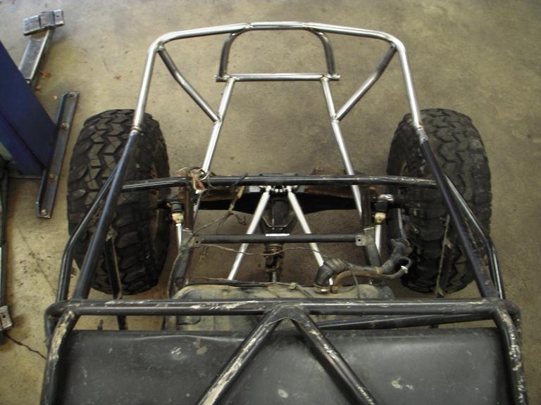

like the rear tube work

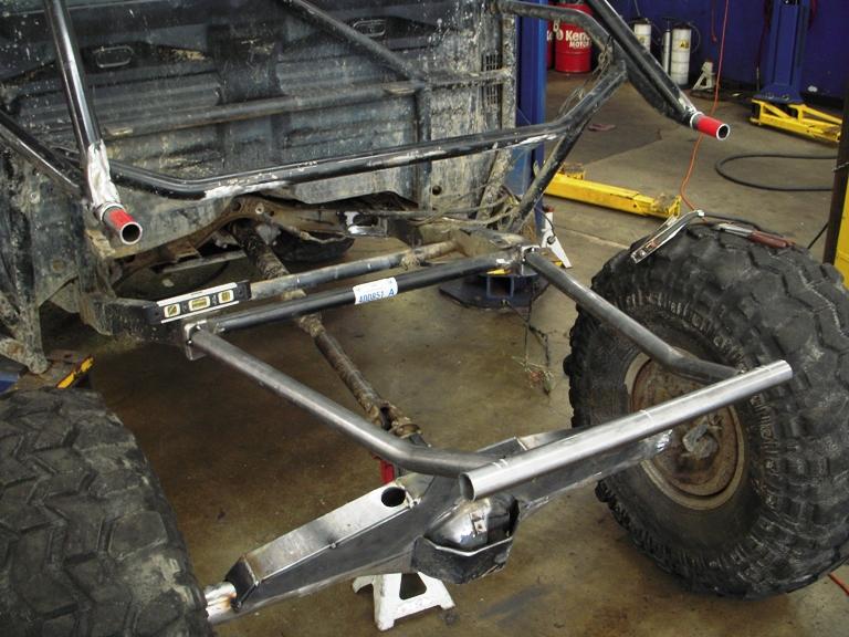

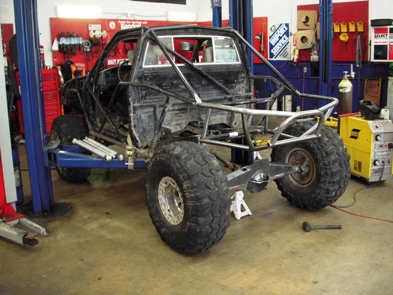

Where are the updated pics from yesterday's progress? I got some stuff on my phone from Keith but I am sure that just does not do it justice.

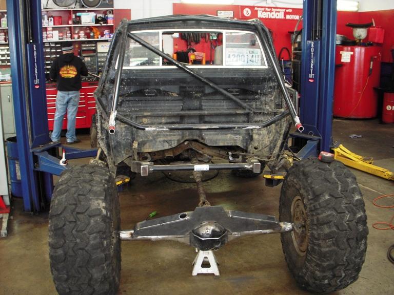

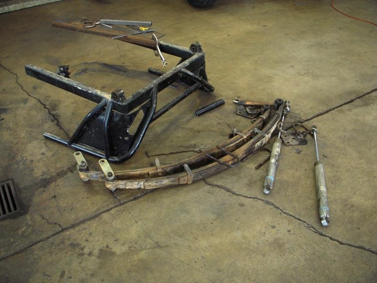

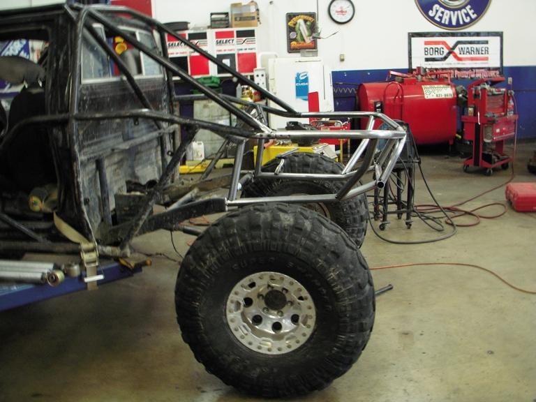

Here's pics from the digital camera in sequence...

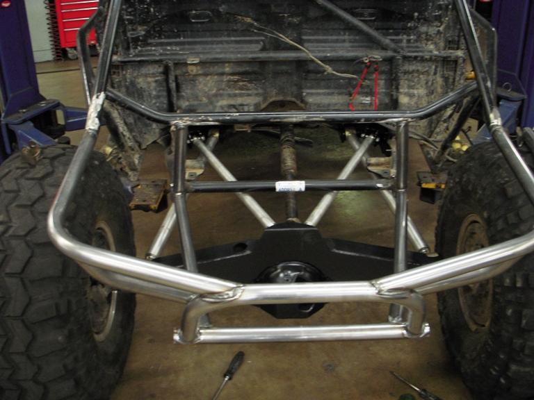

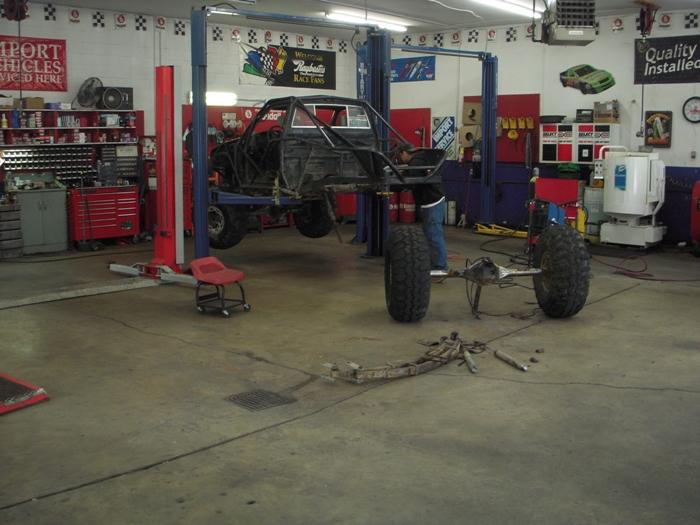

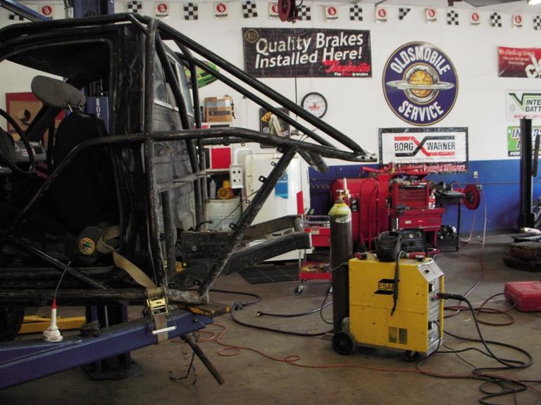

more pics. Wes hung out. Seemed to like the beer and what we were doin:D

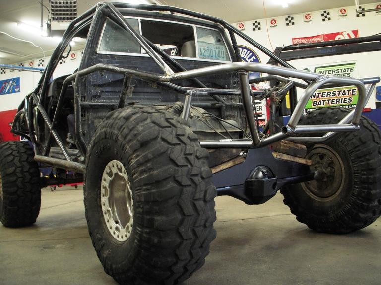

more...
more...

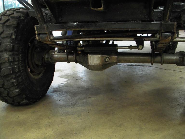

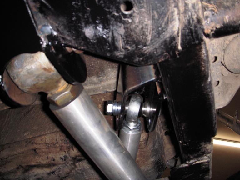

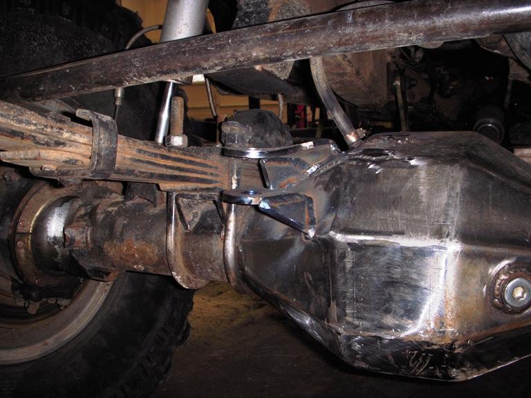

gonna finish up mounting the air shocks tonight. So stoked on the new hydro ram mount also. No more digging into u-bolts & flopping around from the pressure. Moving it allows me to gain up travel in the front end while lowering the truck by an 1" or 2"

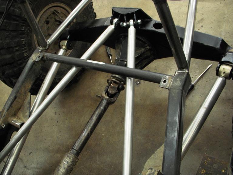

good time to toss that heavy long slip rear shaft now.
Dont need the slip travel with the links. Them things are pretty heavy too.

Did you build or buy that rear truss? Looks like a good design. Might have to steal it when I do mine.
Trucks looking good man!:corn:
Clark W did that truss. Pretty sure he'll be doin a few more here shortly. It worked out great.
