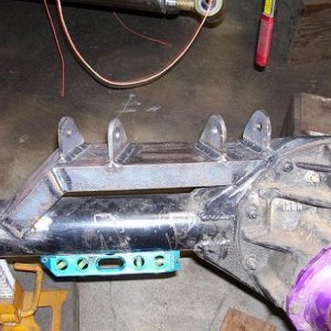

Just an update... I could not bring myself to run with the 130+" wheelbase. I decided to hack up the cab a bit and cut underneath the rear seat and boxed everything in. Thanks for the idea Dillonm. I even lucked out.. the holes that used to be for the factory jack and everything make it easy to pull the link bolts out ;D. I hope to get some good pictures this weekend when I'm back at the shop. Wheelbase is now 123" with the front axle stretched as well. Belly around 22" and rear flex is about 18" before link hits cab at current setup.
