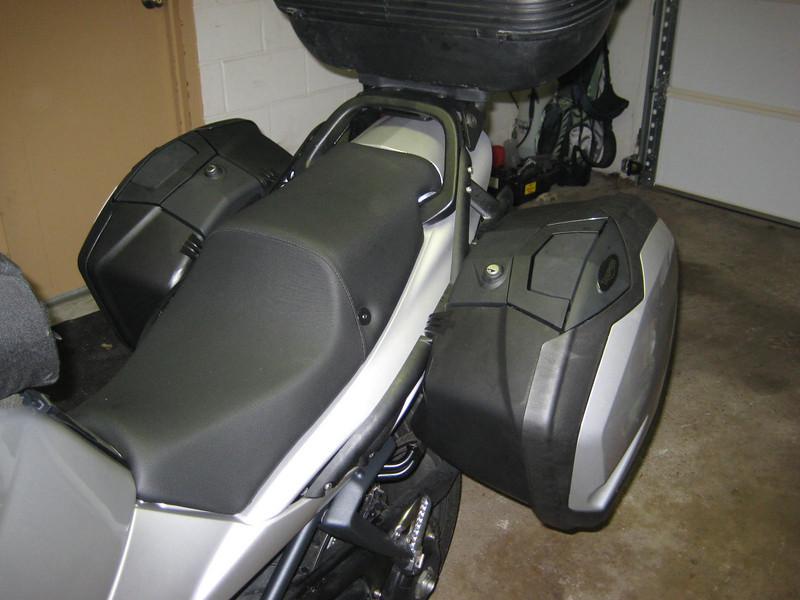

Side bags are plenty small, but I bet I can cram a weeks worth of clothes in each, maybe even a sweatshirt.
Still have another bag where the passenger sits for camping gear.
