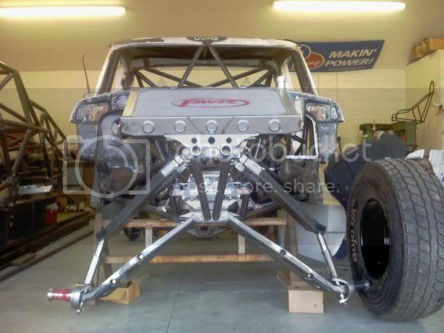

Similar to what he has here. This is what I am thinking. His motor is a little more forward, because the A arm is more like a buggy A arm. It's all tube frame which gives him alittle more play area. Plus I think his front is out a little further.

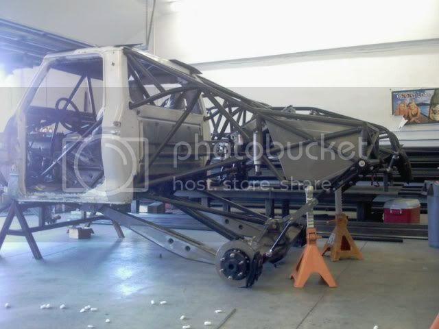

Starting to work on the truck agian. I managed to get the front end tacked in place. I ended up having to cut out the firewall for clearance. As of now I have a good 13"s of up travel. Should be real close to the same for the down travel. More than likely I will strap it at 12". It's actually setting pretty close to ride height. It sits now at 18" and at full bump I should have 5" under the front. Thats actually kind of high. Most of the trucks have about 2"-3" at full bump, some even lower. The track width is about 2" + wider than stock.
Flexing out. I think my motor is alittle off set.
Part of the Yframe supporting the lower bulkhead.
Sporting that classic TT stance. It's starting to take shape.
A buddy of mine is coming over this weekend to check to see if i'm ok where everything sits. Then it's back to adding tube, hopefully get the engine mounted and the front engine cage done.
I pulled a line from front to rear and I may be off by 1/16 at the most. I can live with that. Considering the truck is 35 years old thats not too bad.

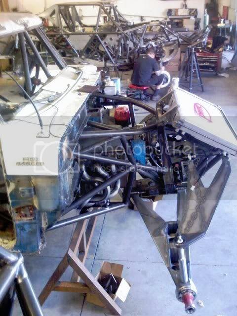

Ya, I've stared at it about 100 times over the past few months. He's put over 3000 dirt miles on it since he finished it a few months ago. I believe this one and the 74 ford prerunner build are running buggy front ends that have been grafted onto the truck Theres alot of f100's being built on RD site, but I've only seen two that have A arms. The rest are running beams. I set my motor up today and got it to the front enough to get a cherry picker on it to pull it. Plus I figured out the game plan on my seats. I am going to use the stock sliders that came with the truck. They just fit to good not to use them. I'll have plenty of room to move the seat forward to access bolts to get the seats out.
