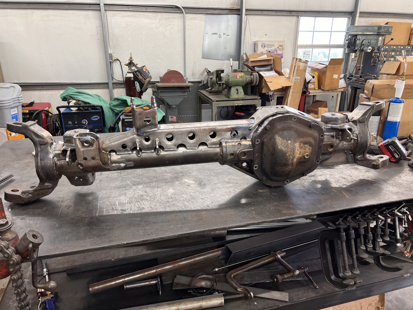

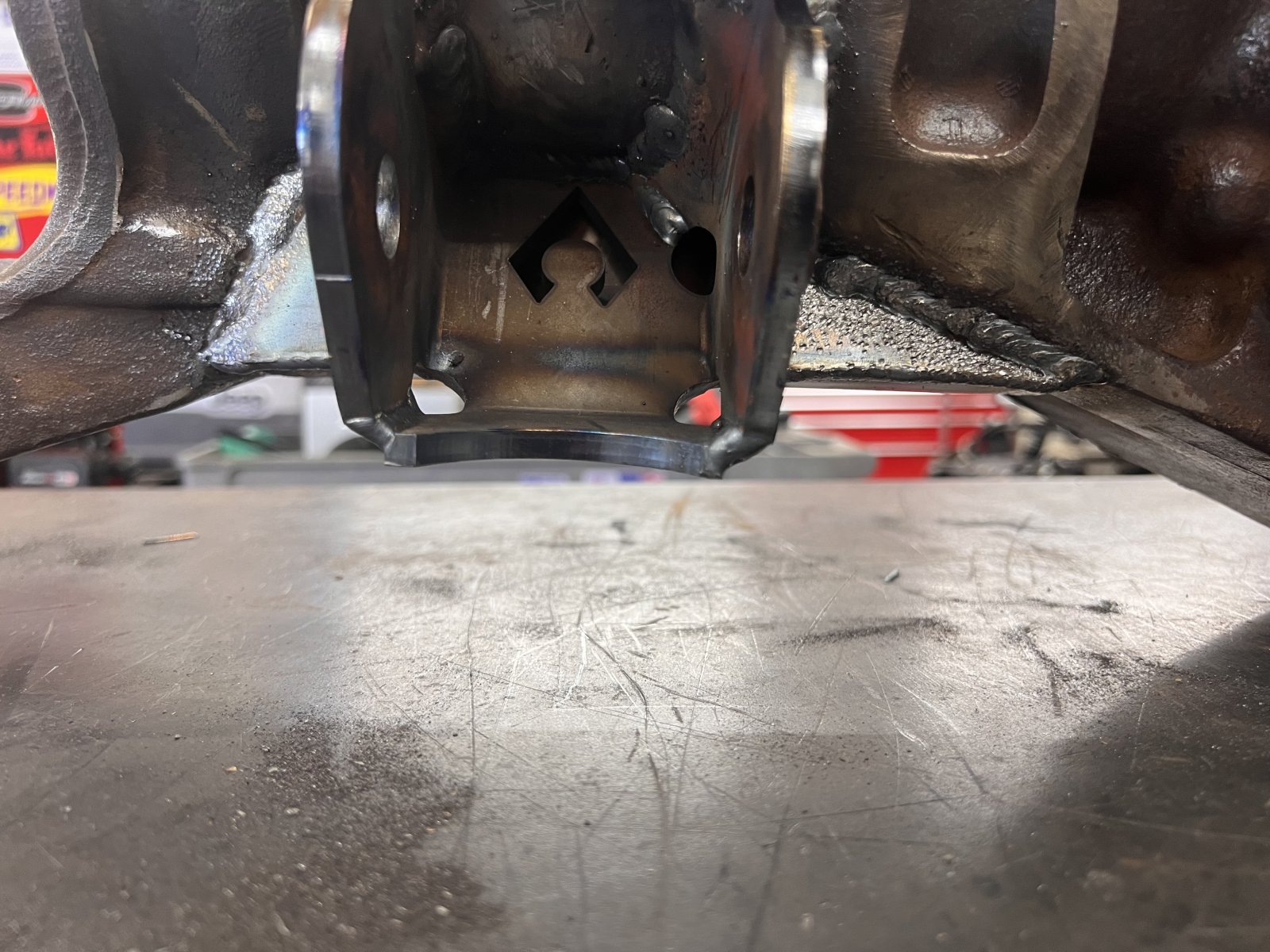

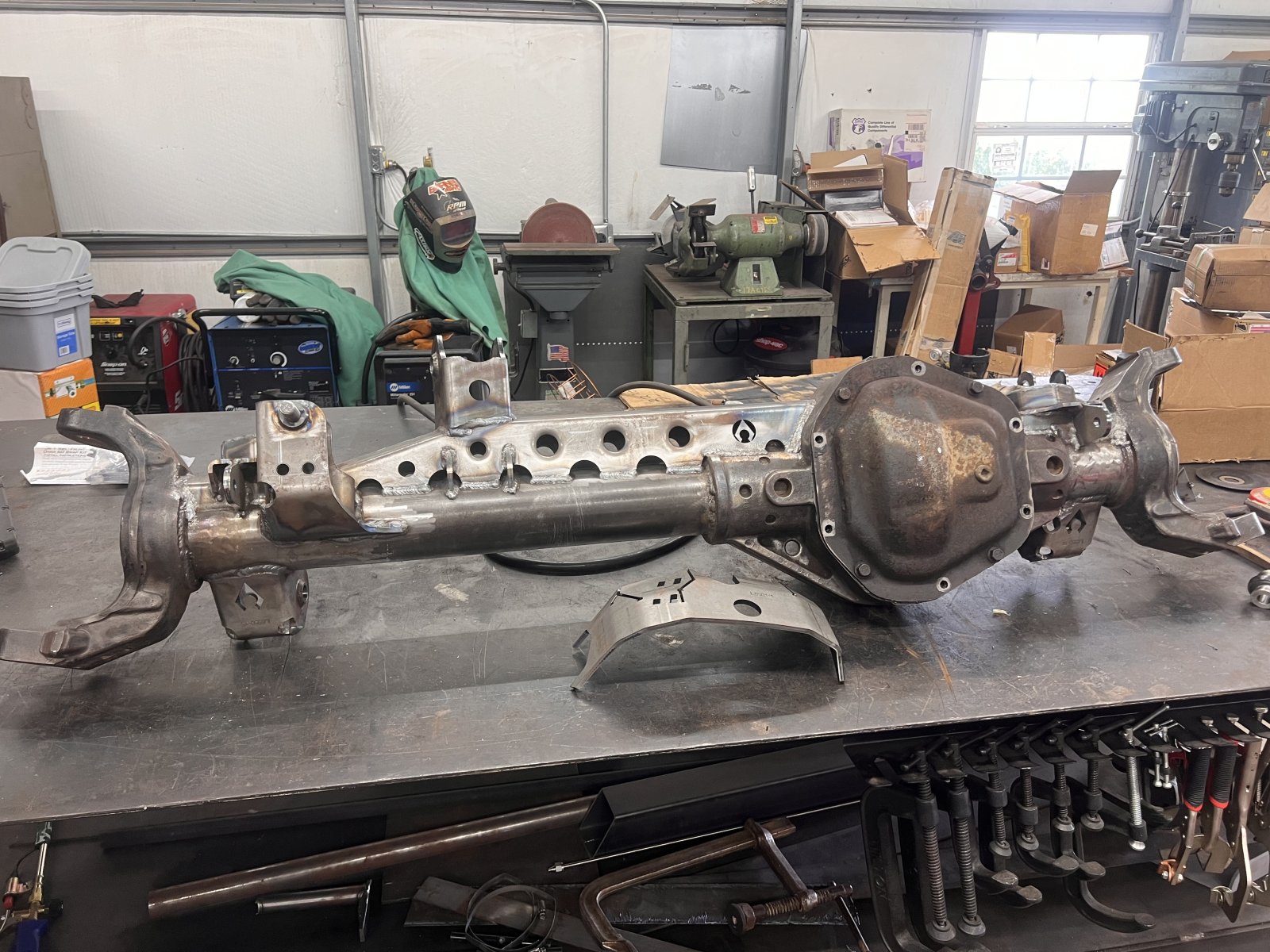

Almost finished with the welding on the axle. I need to decide if I want to run the bridge piece across the diff or not. It's really only needed with a factory style 4 link to give a mounting spot for the upper. Most likely I'll leave it off. I've been very happy with the way this thing has fit together. It's a nice piece for sure.

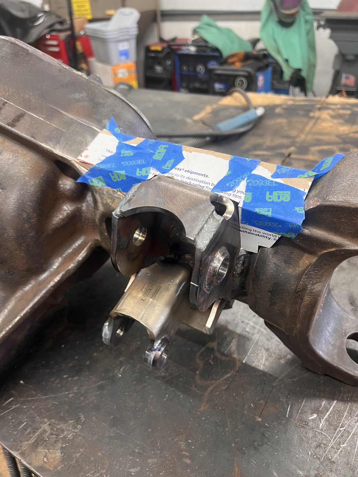

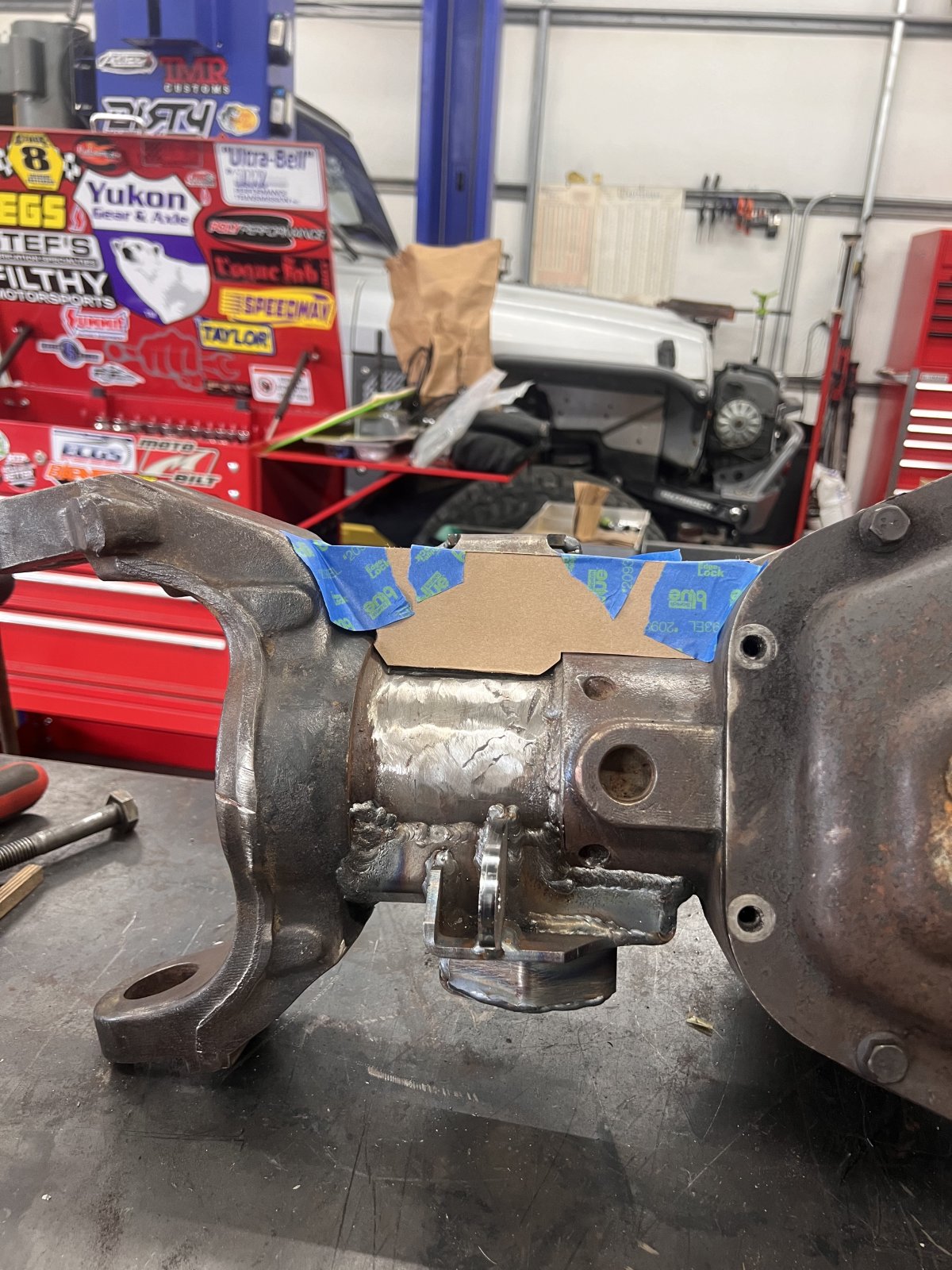

I decided to do something to reinforce the driver's side tube where the casting is cut back. I've seen a few pull the tube out there. The CAD work is done for that, just need to cut it out and weld it up.

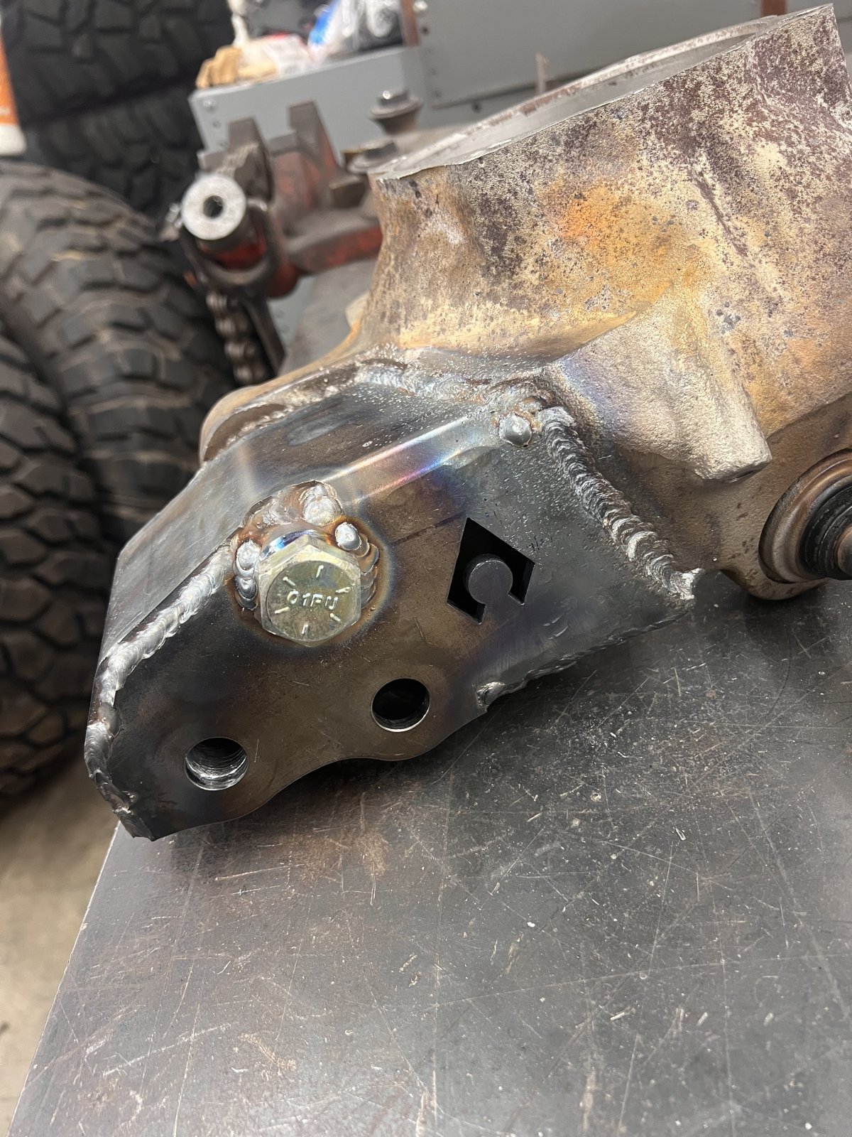

I got the driver's side tube reinforcement cut out and welded up today. It's a little ugly, but that tube is definitely not pulling out of the casting. :ROFLMAO:

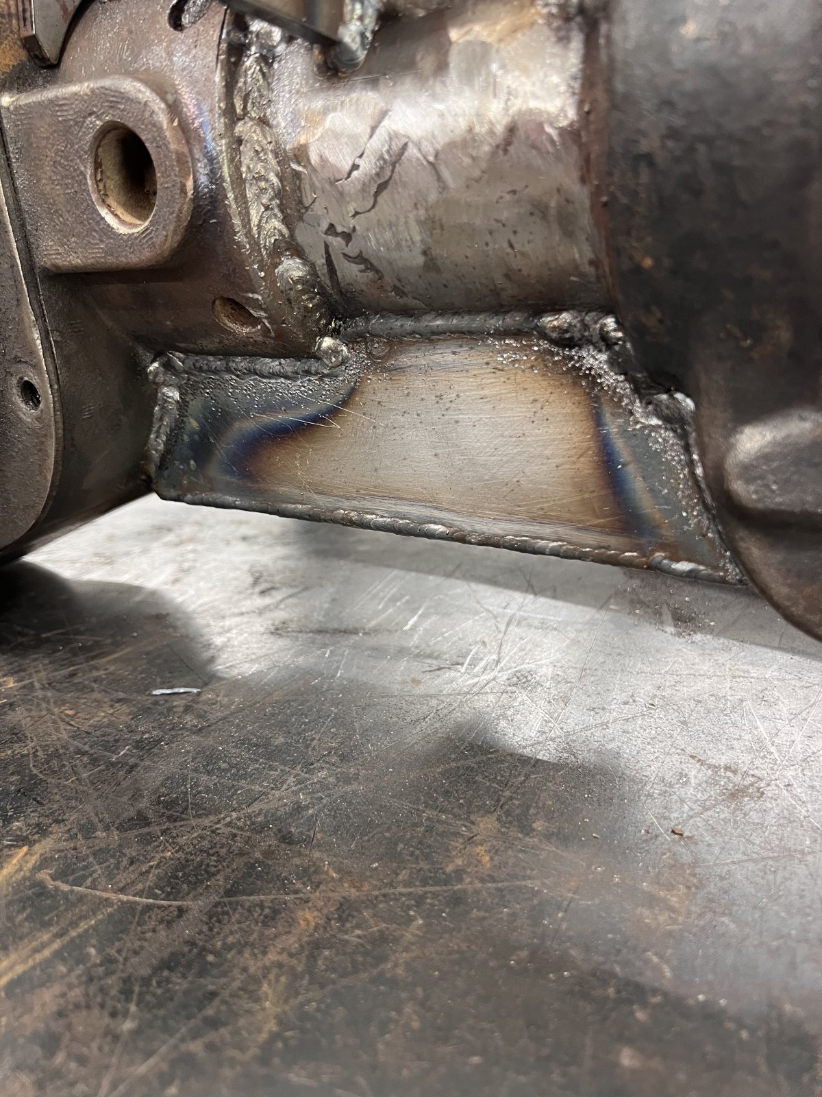

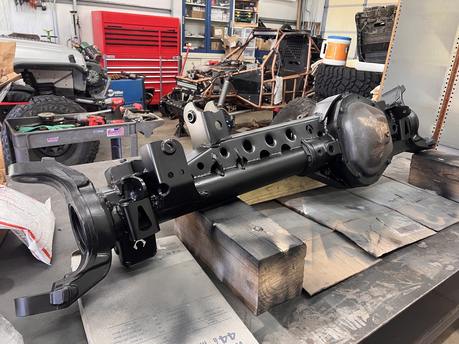

I decided to go ahead and do the bridge across the diff too. Hopefully I can knock that out Friday morning before work. After that updates will be slower than they already are. Friday starts probably about 50 straight 12hr shifts I'll be working. Starting a plant shutdown that includes a complete PLC swap and checkout/startup of the 1400+ I/O loops. Getting up to do anything before work will be a challenge.

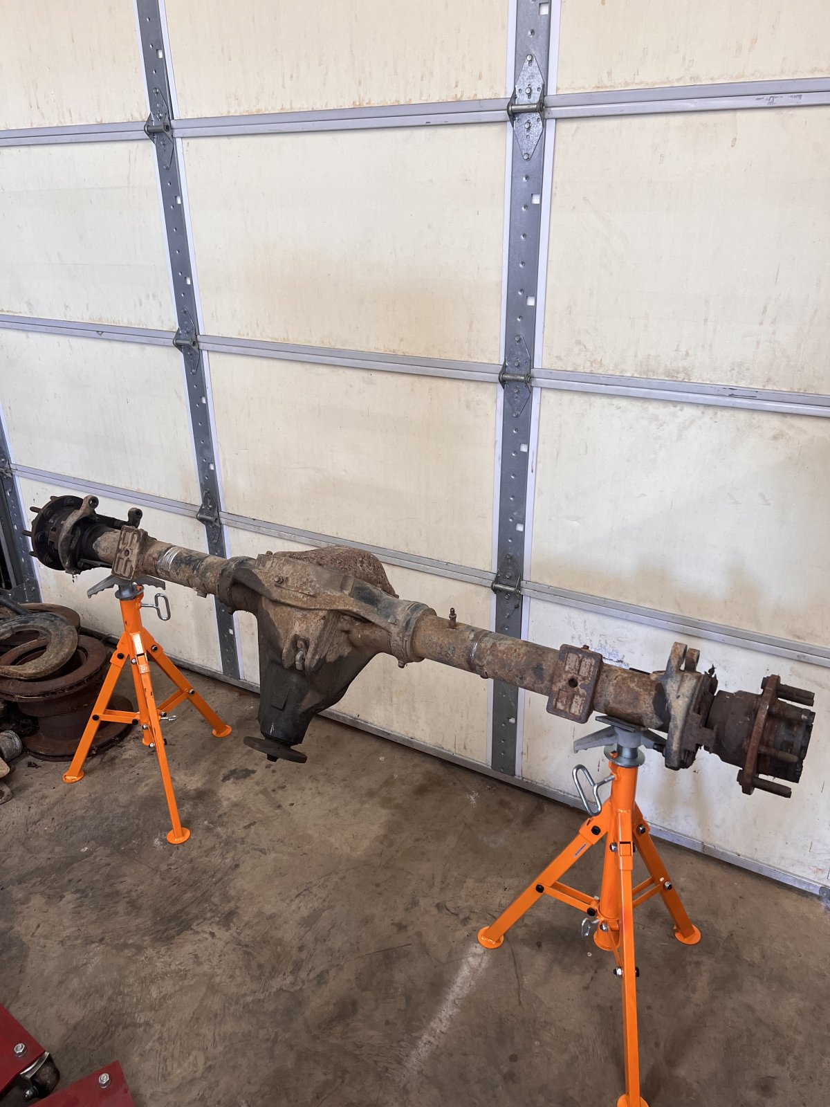

Had a couple hours of shop time today so I spray bombed the 60 and got the Sterling up on stands to start tearing it down.

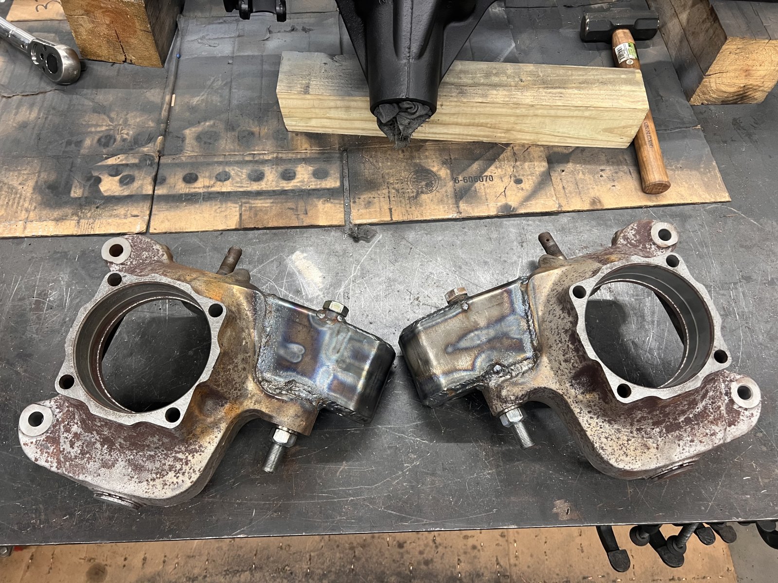

I brought the knuckles in to work with me tonight to put them in the blast cabinet to get them ready for the weld on steering.
