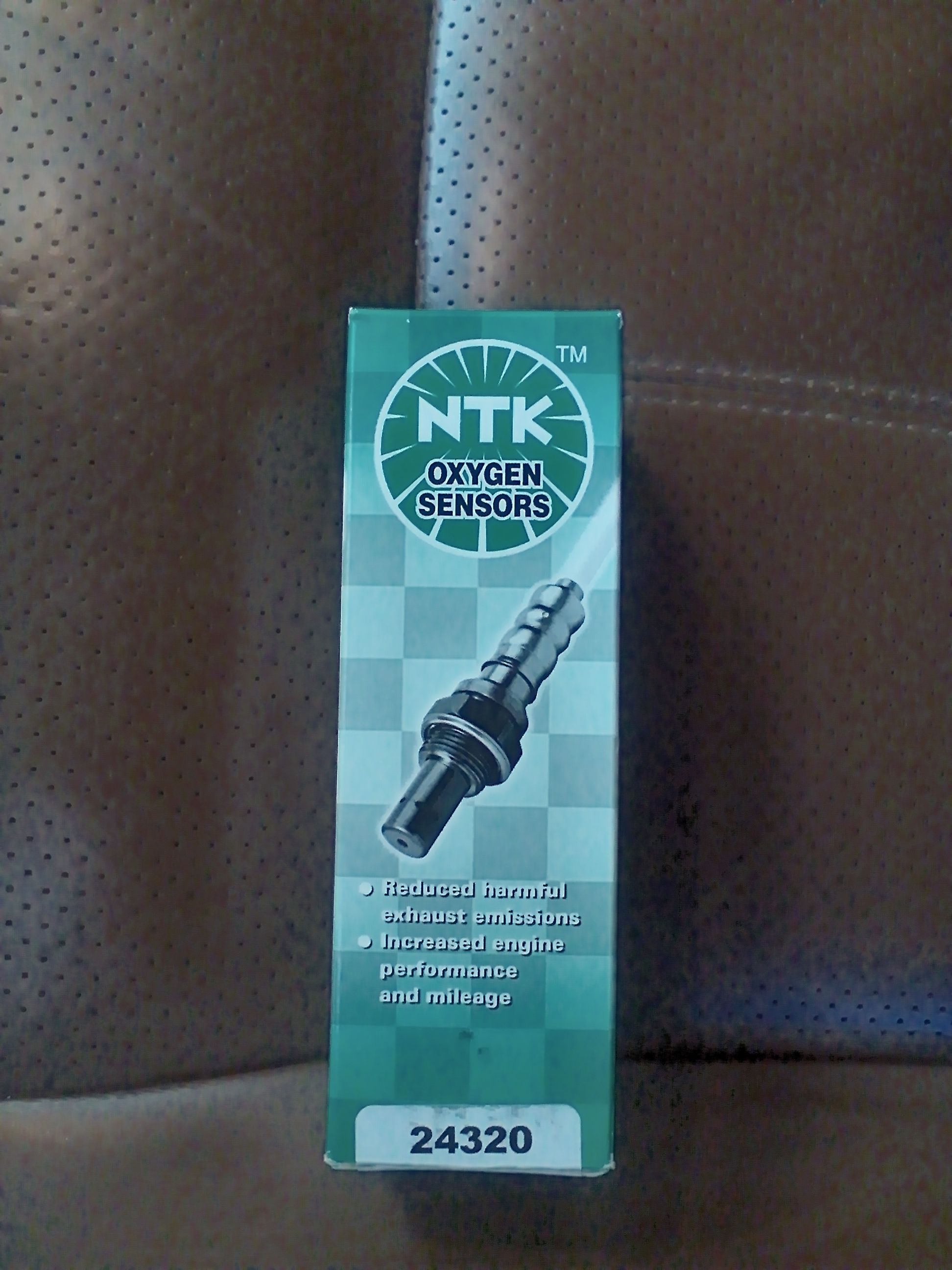

Well guys If anybody is interested, I fixed my fast EZ efi system. Changed brands of 02 censor. The kit came with a bosh so I kept buying that brand. I had three. This time I went with a kdm or KTM brand and BAM!! Fixed it. Reach in, hit the start button, wow. Perfect. No gas smelly cloths after a ride now. Can't wait to go riding again.

That's some good info. Thanks. You wouldn't happen to know the part number, would you? :eat:
I'm in Florida (in this freaking hurricane) now. When I get back this weekend I'll post it. I've been driving this sob like this for three years. It's fantastic now!!

Dang, be careful. Take tour time. I will try to research it a little. Trying to get poolman's buggy lined out and i think that might be the idling problem. My mom and dad live in Winter Haven,FL and he is stubborn and refuses to leave. Worries me to death sometimes.
I'm also interested in the O2 part number whenever you can get back to Florida
Here it is
Definitely gonna try this on a fast system I installed for a customer of mine. Put it on a brand new crate 350 and it just has never performed the way both of us thought it should've...and of course it makes me look like I did something wrong but installed it to a T! Thanks a lot for posting this!

use holley ntk one they have sensors calibrated with resistors in the sensor wiring. and make sure you change sensor type in program
My update. I've been to Harlan the last 2 weekends in a row. First weekend with the Bosch second with the NTK. It definitely ran better with the NTK, not as rich as before but it did act up twice for about 5,10 minutes, both times coming down the mountain. Maybe it's the elevation change????
