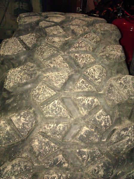

I think my Jeep is too heavy for 12.50's but my steering is up for them...these tires were pretty smoked but look a lot better now and will work on rocks
