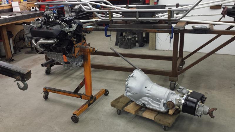

MY new headers showed up finally (back order). I decided to go ahead and replace them since the early headers don't work on the vortec motor without notching the flange on the top side.

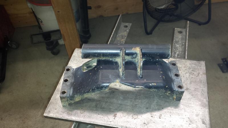

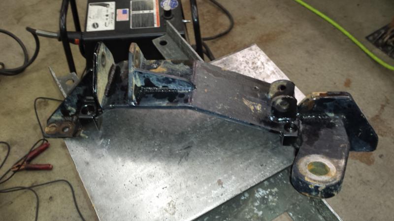

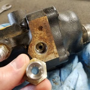

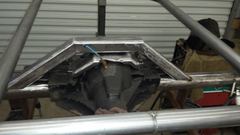

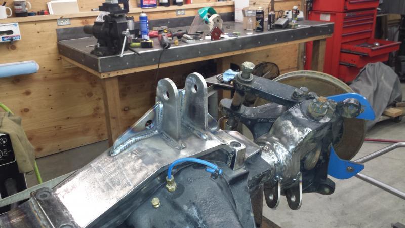

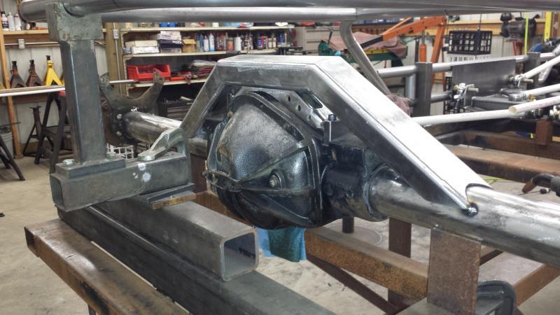

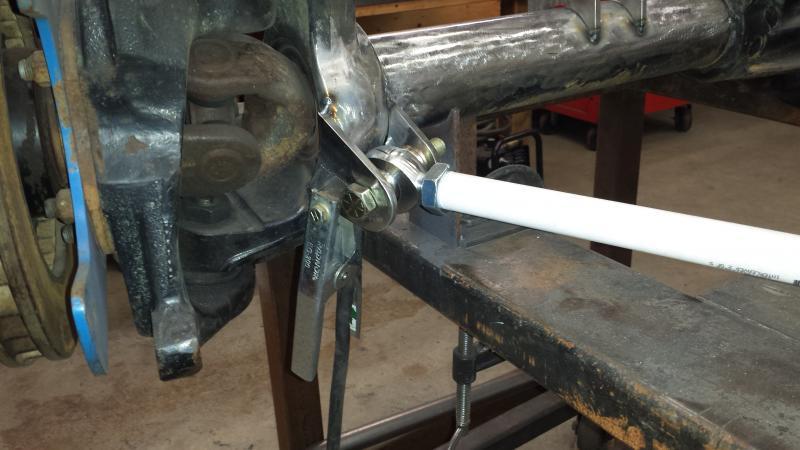

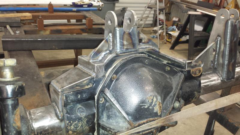

So next I decided to go ahead and get the housings prepped. My original plan was to strip both housings of the brackets since they were so hammered and I am really thinking of going double ended ram on the steering.
One thing I love about the Pro-rocks is the suspension bridge--noo welding needed to the cast. To remove the bridge I had to cut the 1/2" plate for the old steering ram.

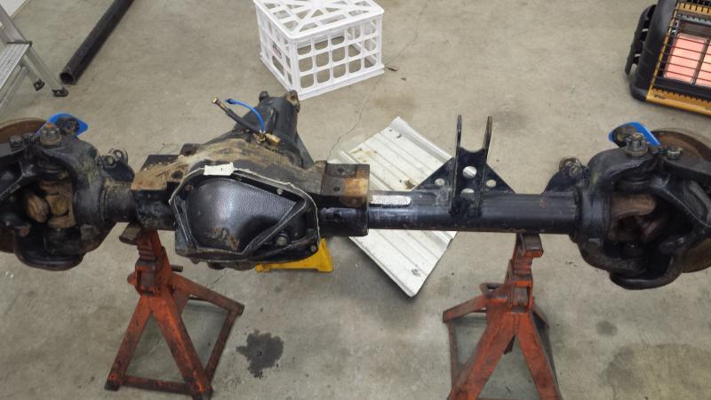

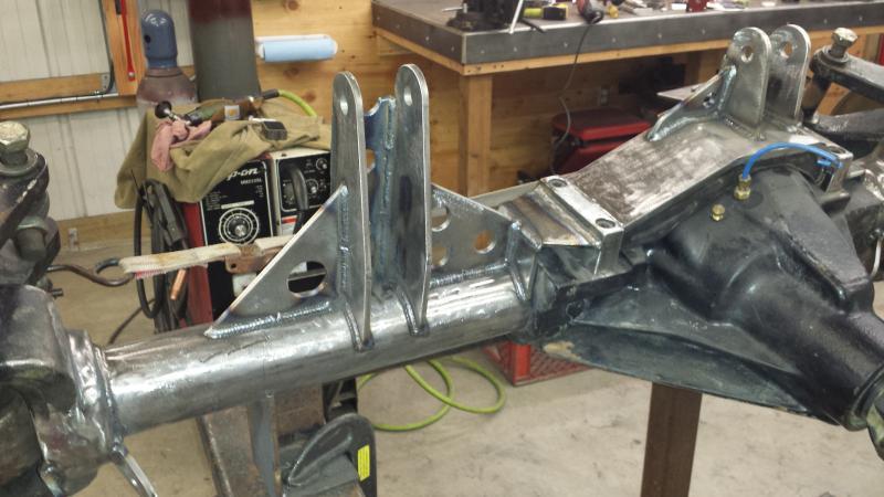

Got the front housing all stripped.

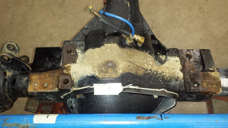

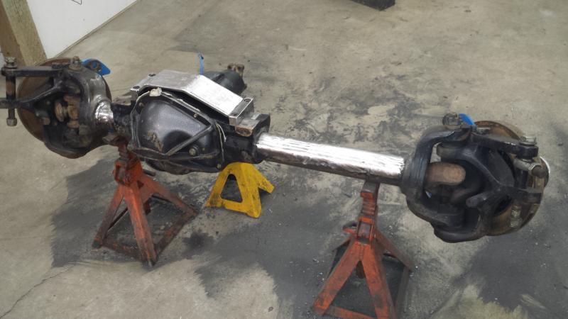

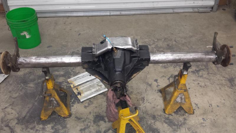

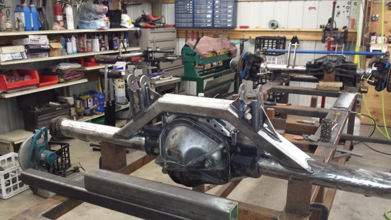

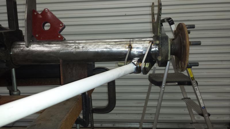

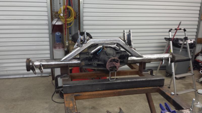

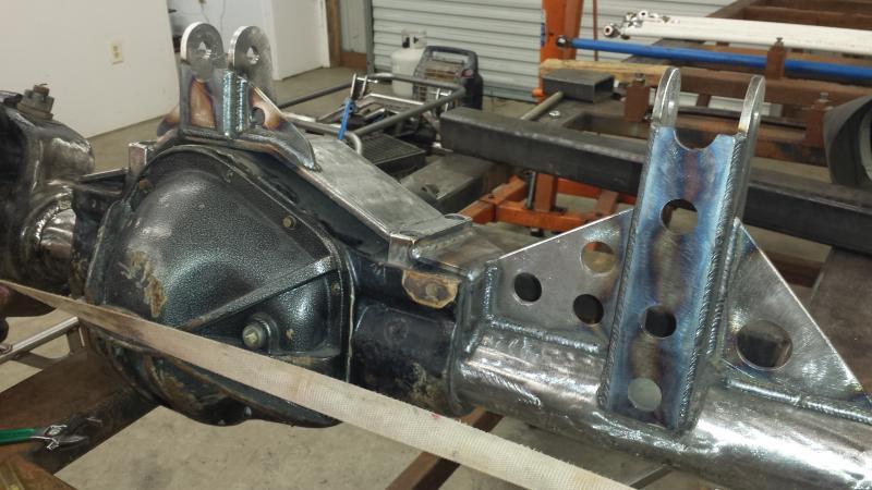

Like the front I cut the nec items to remove the bridge and again cleaned it and the whole rear housing of the brackets. I left the brake caliper brackets on for now and more than likely I will be redoing them to roll the caliper down.

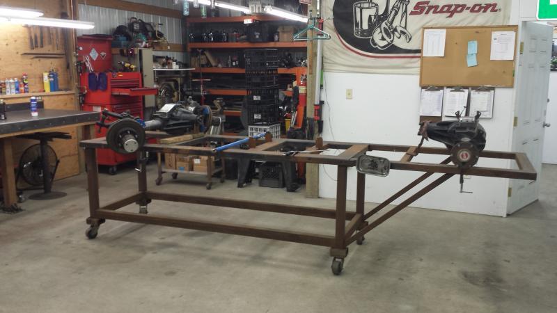

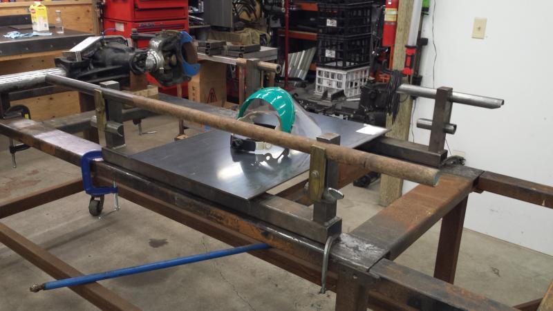

Got the diffs lifted up and onto the table. I had to make holding fixtures for the diffs so they would stay in place,lol..
getting close to GO TIME,

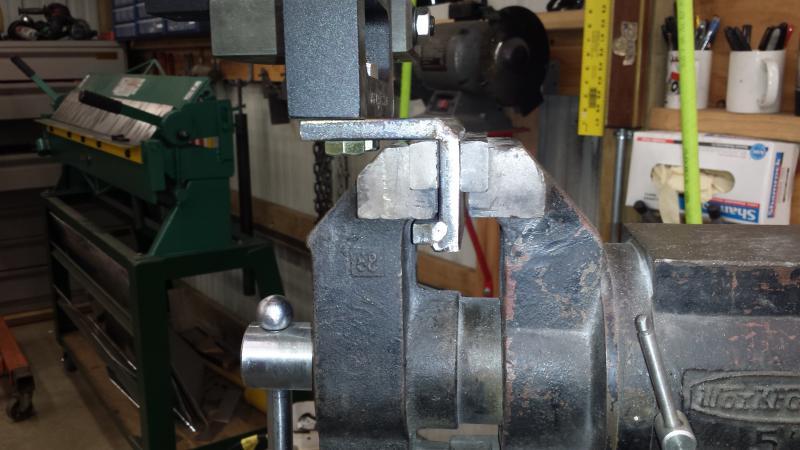

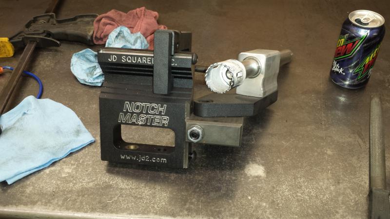

I got this a couple months ago to replace my worn out pro-tool notcher. Figured it was time to make the mount for it.

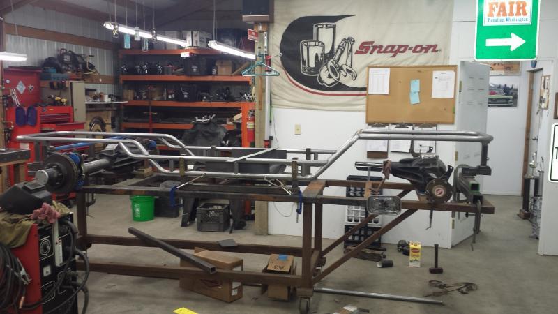

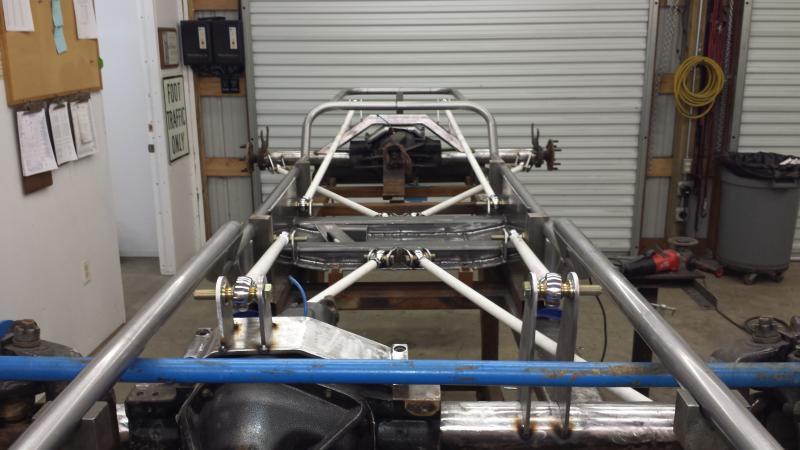

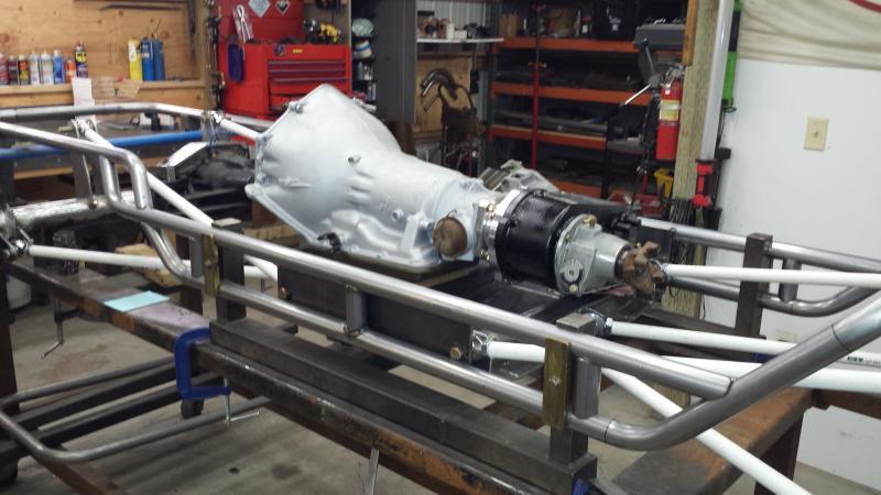

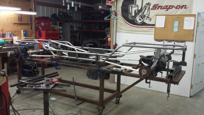

Time to get this show on the road.

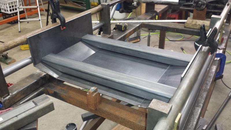

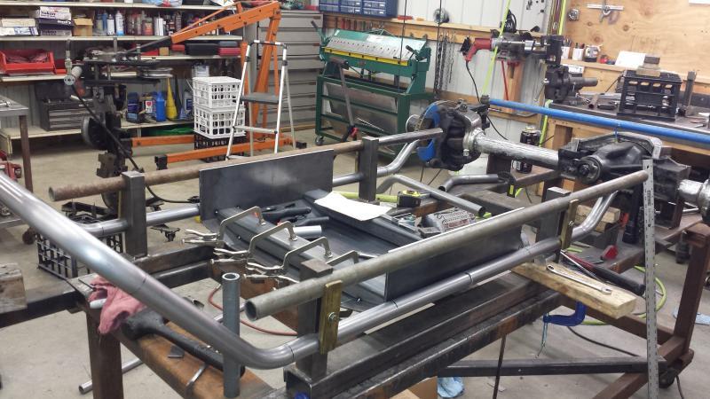

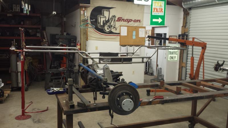

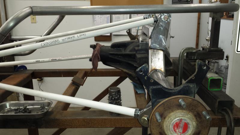

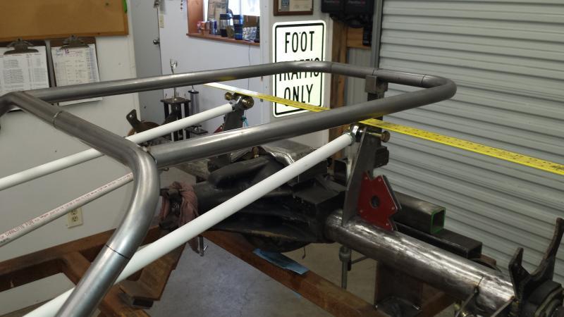

Like I had stated the bottom or "sled" was going to be strongly based off the S&N Bravo 2 chassis. First I had ALWAYS admired its design and the second awsome part is the fact I have all the jigs to aid me in doing so..
So after looking over man pictures and going up and measuring on it was time to jump into it.
I simply started by getting the skid roughed into place and getting the side jigs in place. Over the course of from this picture to the down the road I think I moved them around like 14 times,lol...

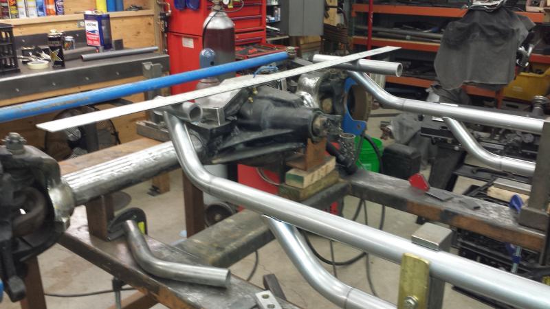

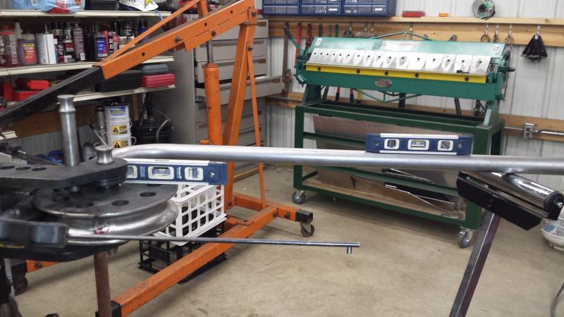

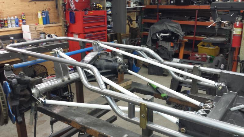

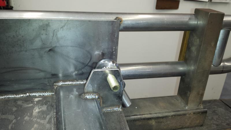

I will say I am not super fast at this and I have messed up a couple bends but I do like to be as precise as I can--probably overly picky but I do like to be spot on.

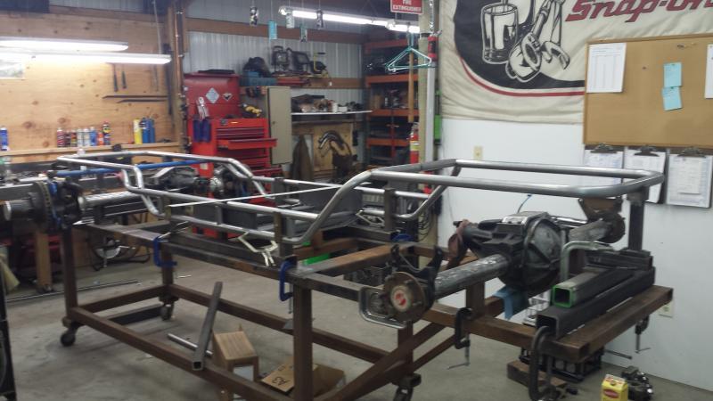

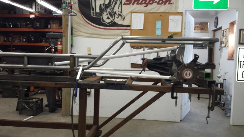

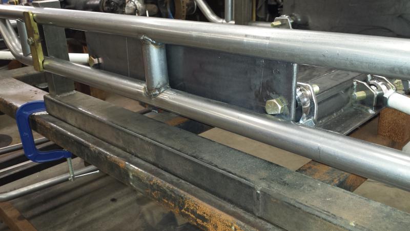

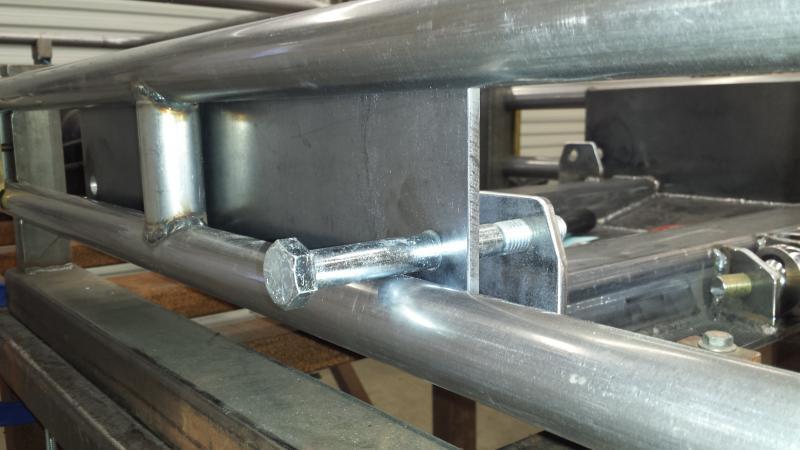

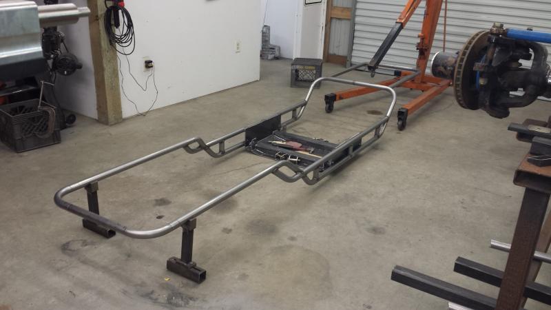

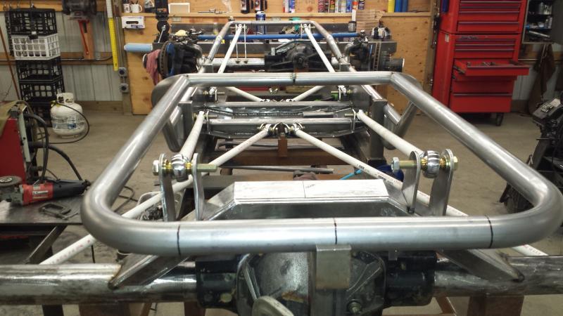

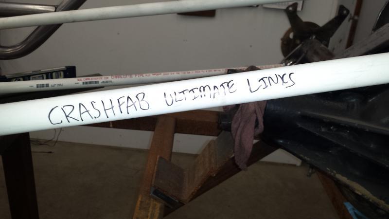

So one thing I found was the lower tube was too short which actually turned out to be a good thing. So I remade the front half of it and I sleeved the whole lower tube. Since that section of tube takes a good brunt of the beating I figured it wouldn't hurt to beef it up a bit.

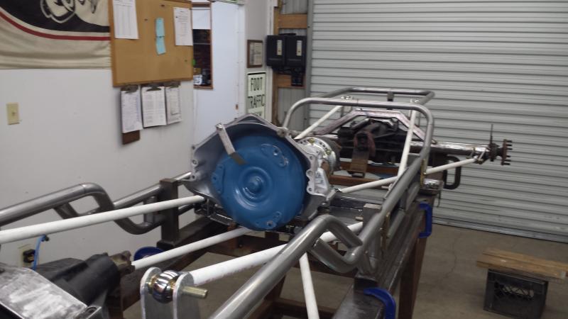

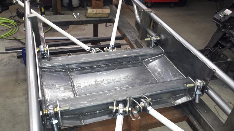

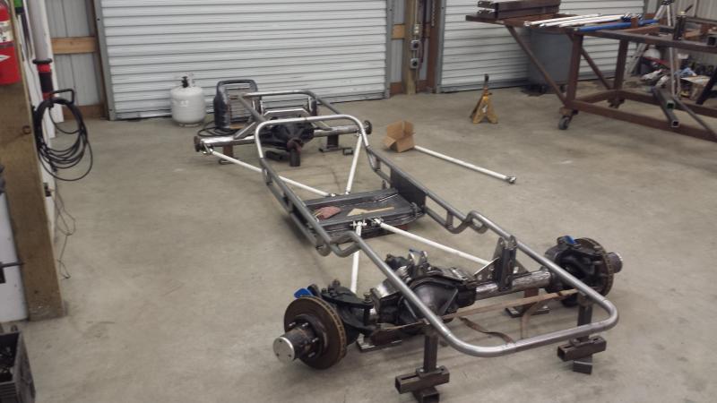

And the sled is done. Its hard to tell but I really pushed the front tube out an did this for a reason that I will go back to once the rest of the chassis is done. Feels good after over a week of work to have something...
