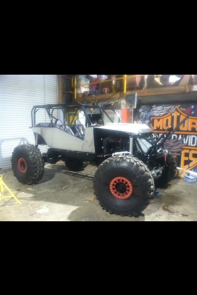

That the same chassis you bought from me? Looks bigger now!
Thats it.
It got wider in the back and lots of redoing to make the big block fit and back seat. Only thing I kept was basically the a and b pillar and stinger.
