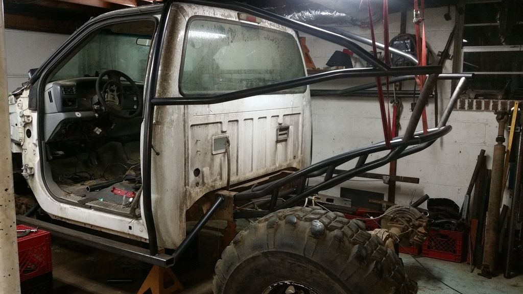

Thanks Pat, I appreciate the compliment. I may post a short build thread on it here in a few weeks once I'm completely finished. Im far from a good fabricator and designer, but I think it should work out alright for the trails.
Tomorrow will my first outting the rig i just finished, wish me luck
MoparMan said:
That's pretty cool Patrick...what's the specs on it?
Keeping it simple for now.
Using the factory axles, keeping the factory 5.4/auto/transfer.
Tube the back and link it with C.O.
Moved the rear springs to the front which moved the front axle forward 4-5"
Keeping the doors since the AC works lol
42" tsl's since they were in the garage
