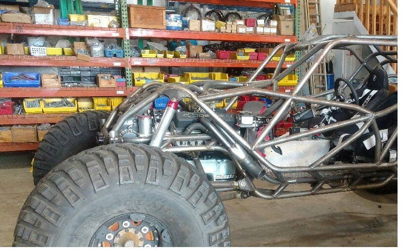

Thinking about going with a Fitech 600 Power Adder, but I am concerned with the mounting of the O2 sensor. My headers are not long enough to get the 18-20inches of exhaust pipe after the installation location of the 02 sensor, so my choice is to run it before the collector in just a single exhaust pipe - does anyone have any experience with this and how have you dealt with it? has it really messed up your o2 readings or ?
I would recommend temporarily adding a 18-24" extension to the collector and then installing the sensor in that. It really depends on your exact application whether reading one primary tube is going to even give you a close reading. You could use the temporary pipe to get it tuned then once youre happy with the tune lock it in open loop and remove the pipe and sensor. I'm guessing since youre running open headers this isnt a street car where you need the precise control of AFR's that closed loop gives you anyway.

purely off offroad. I do like the idea of installing a temporary pipe and locking it in open loop - assuming fitech can do that?
Funny how the Holley and Fitech folks say the O2 sensor needs to be 18inches from the end of the tail pipe, but the Fast photo shows it clearly less than 18inches from the end of the tail pipe on the temporary piece they sell??? Wonder if the Fast system does not have the same requirement?

My buggy runs awesome with no 02s. It was tuned with one stand alone just to monitor the mixture but my actual software has never seen one. Those things are just something else to give the pcm a headache.
The camshaft you run has alot to do with what will work and what will not work. Looking at your pic I'd say you could install the O2 in the collecter and be just fine, you just have to realize that the O2 reading will be inaccurate at idle and low rpm. If you have a decent sized cam its not going to be able to self learn at idle and low rpm anyway though. I have not directly dealt with FI tech but you should Have the option to disable closed loop below a certain RPM.
