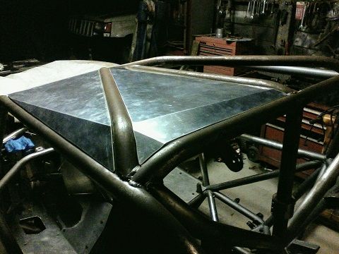

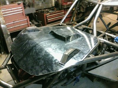

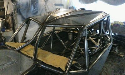

Started the aluminum stuff late last week. Still alot of work to go in the dash and plenty of fitting left to do in the skins, but it's taking shape slowly.

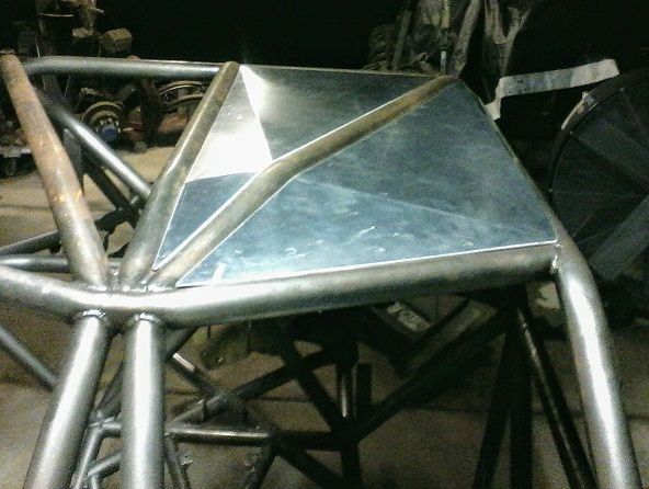

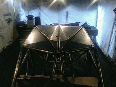

Start of the floors, the firewall will be built off these as well.
These panels will be separate from the firewall. I'm hoping to create a decent air gap between them to help keep the lil "mufflers" from cooking the insides.

Chopped out the very rough skins, most of this stuff is still at it's rough cut stage.

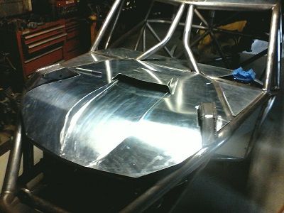

First cut on the dash
Bent the dash around and got the filler panels cut and taped up for now. As well as the center section.

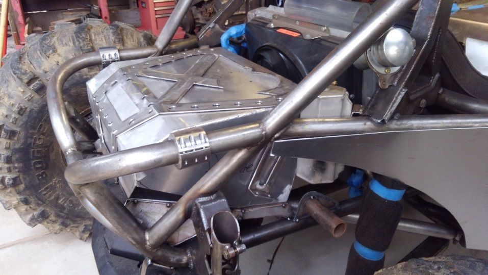

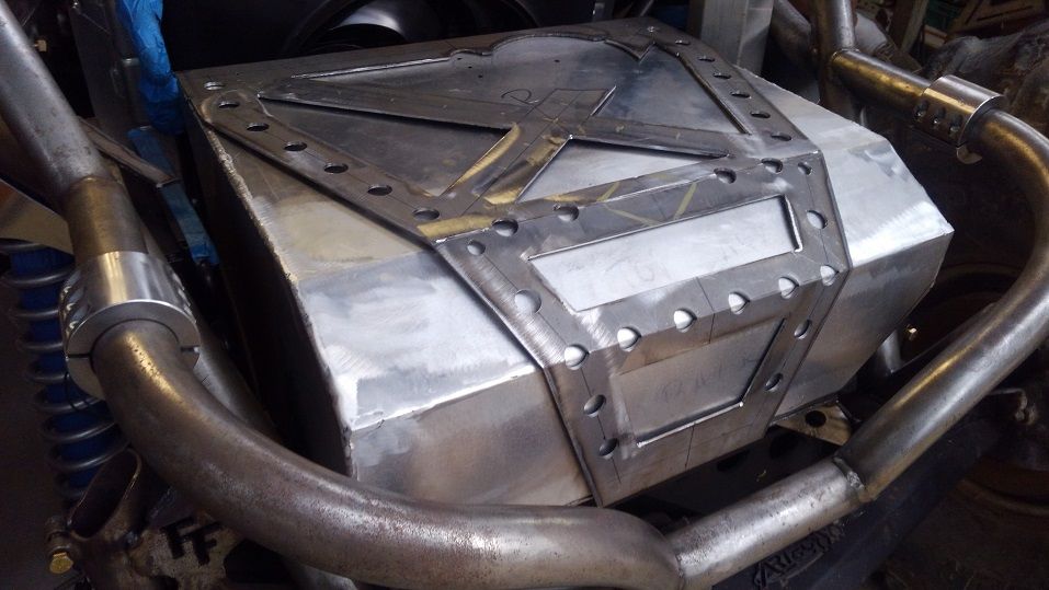

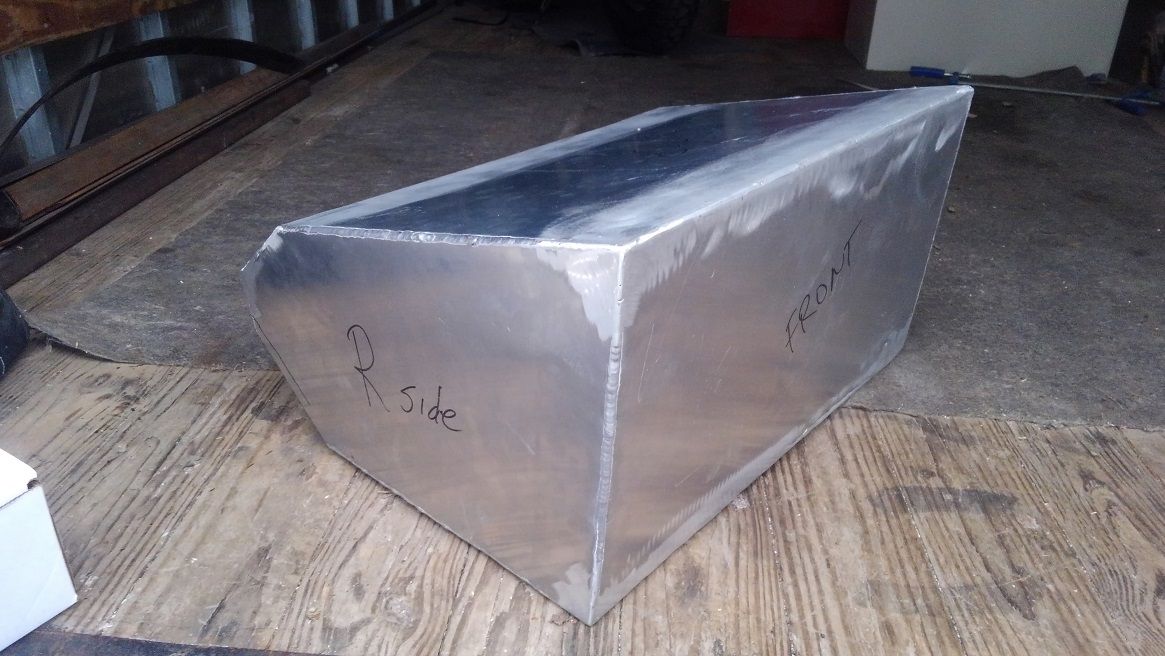

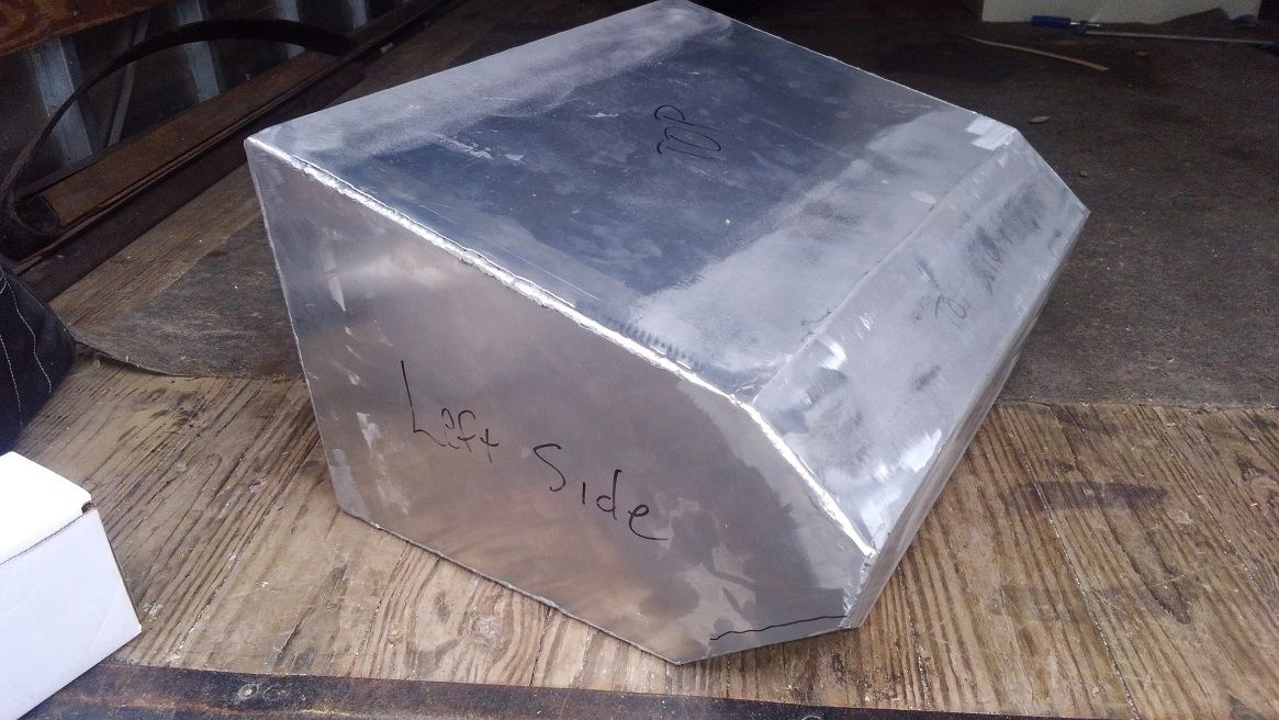

Dillion started working on mounting the tank. Initial thought was to use weld on pucks...but after some discussion it was decided to mount the tank fully supported from the bottom with a tank "strap" that covers the entire tank.

MihlfeldL2005 said:
Out of curiosity, did you add internal baffles in the tank at all? Or will it be getting foam?
The tank is not fully done yet ….but no foam and yes to baffles.

Yea, I've never been the biggest fan of the puck mounted gas tanks, lotta weight bouncing around on them things.

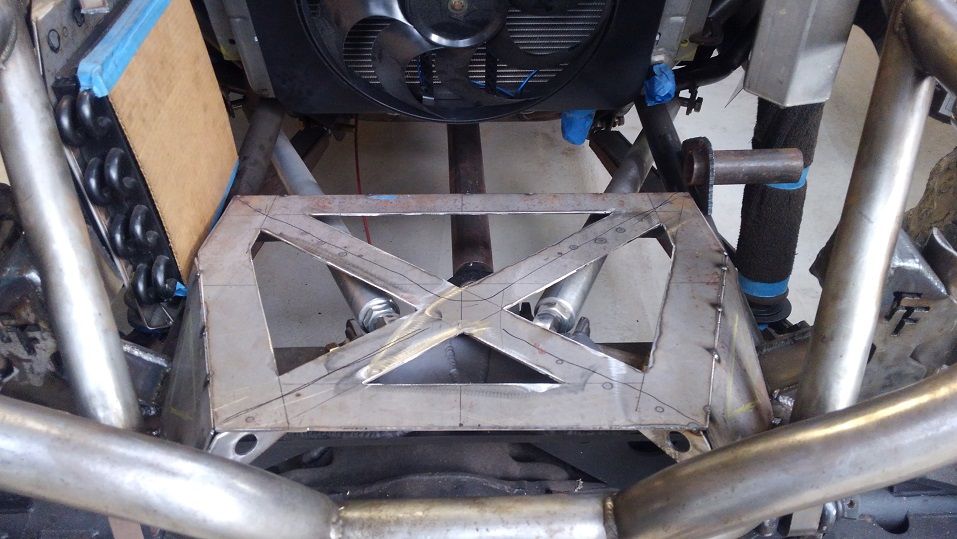

Template stuff
Couple of gussets on the bottom of the tank mount.
Hold downs for the tank strap
Don't mind my junk welds
So this lil thing serves a couple purposes, it holds the front edge of the tank and also mounts the lower part of the heatshield/air deflector for the fan.
Upper mount is built into the tank strap.
