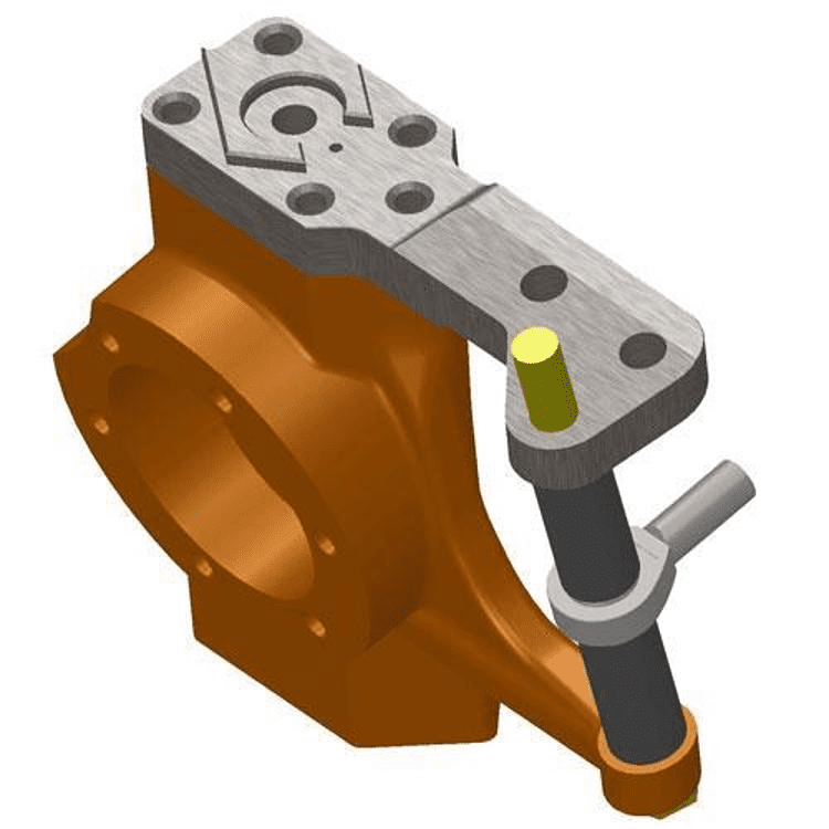

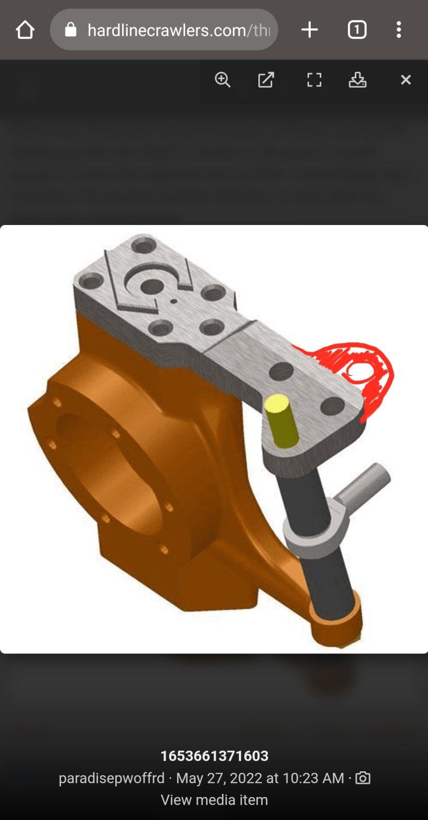

On those arms, looks like you could add some width to the outside so there is some meat around the bolt hole, add a key toward the front like RustyC drew.
And probably make it out of something better than A36 hot roll plate.
If you're gonna one-off it, go ahead and do some chromo plate, or 7075.

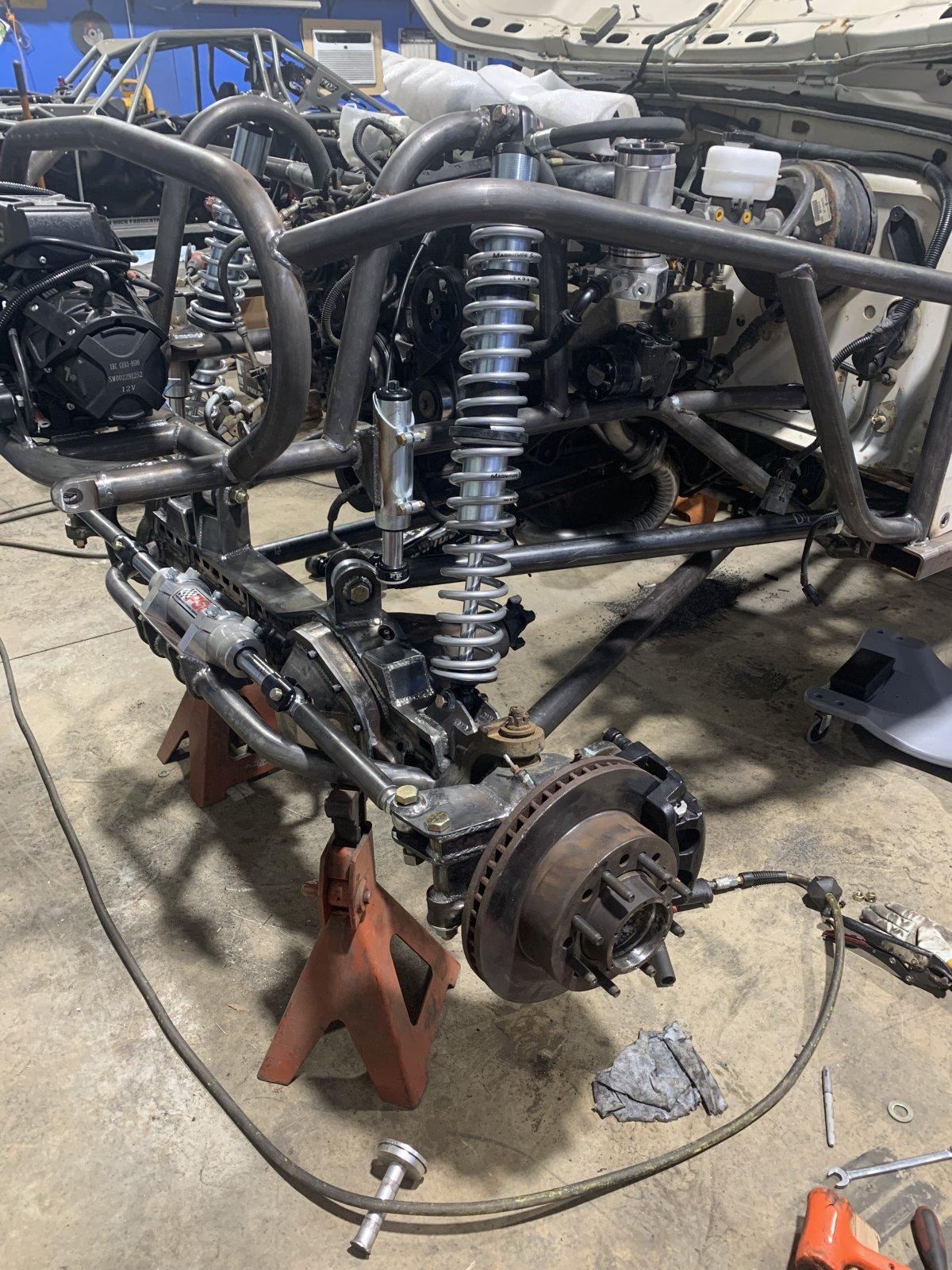

I have same high steer arms as Enzo, but double shear, and I broke one of my arms. If I ever do another set, I'll do a set with a keyway like BK does, or something similar. I would like to have a set of S&S C's and knuckles, or the ones Austin sterling is designing, but I'm poor, so probably won't happen.Looks like you've got room to double shear the steering but I'm guessing you've got a reason for not.
Price wise by the time you send the knuckles off to get machined or take to a local shop, along with put BJ eliminators, good lower Ball Joints, either machine out a set of F350 inner C's or buy the Spicer C's I bet the price will be about the same as Austin's new setup.I have same high steer arms as Enzo, but double shear, and I broke one of my arms. If I ever do another set, I'll do a set with a keyway like BK does, or something similar. I would like to have a set of S&S C's and knuckles, or the ones Austin sterling is designing, but I'm poor, so probably won't happen.

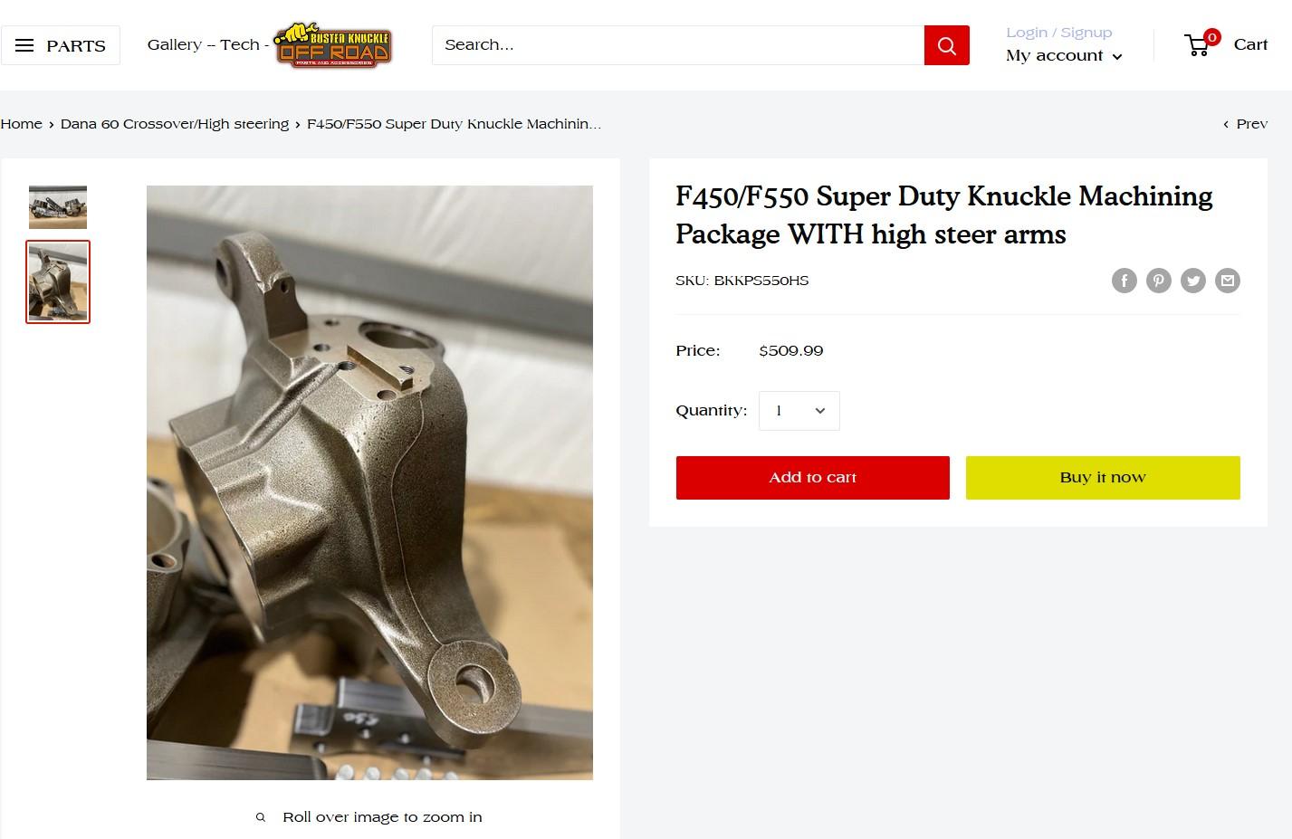

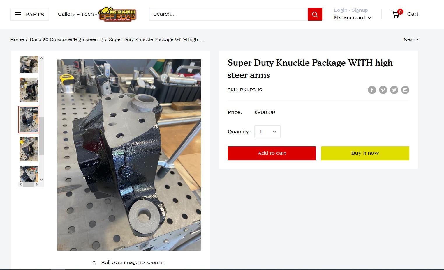

I thought I seen where it has a keyway on 250/350 knuckles as well, on a video they posted, but I could be mistaken. Enzo may know, I think he talks to Jake, occasionallyI have been looking at the BK Offroad for a high steer solution for my 05 up knuckles.
I see that they machine the F450 knuckle to leave a key behind. It looks like there is no key in the F250 knuckle. I think it would be great if they could incorporate the key onto all the knuckles they machine and a matching keyway on the steer arm. View attachment 206675View attachment 206677
