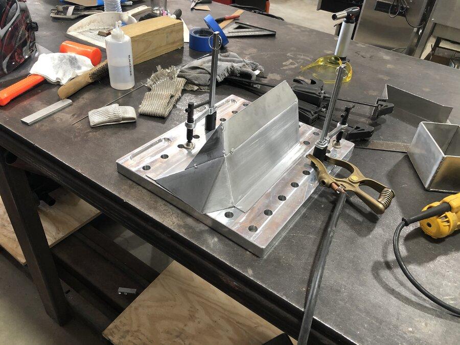

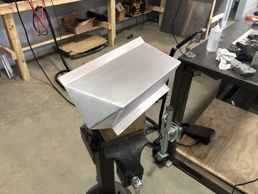

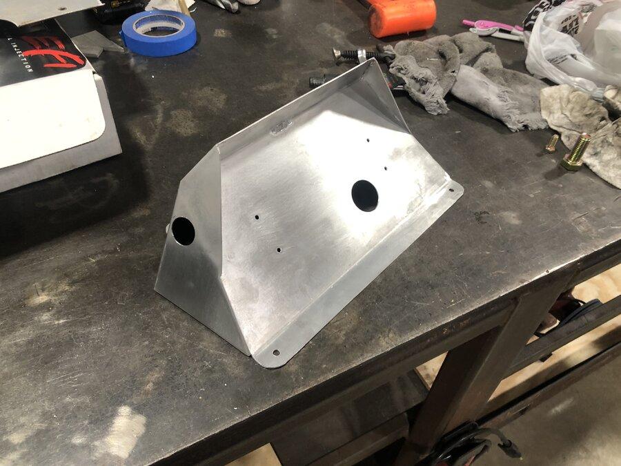

New radiator support made by Bent Fab this past weekend.
We also redid the front end tubes to widen it about 3/8" so we had better access to the radiator.

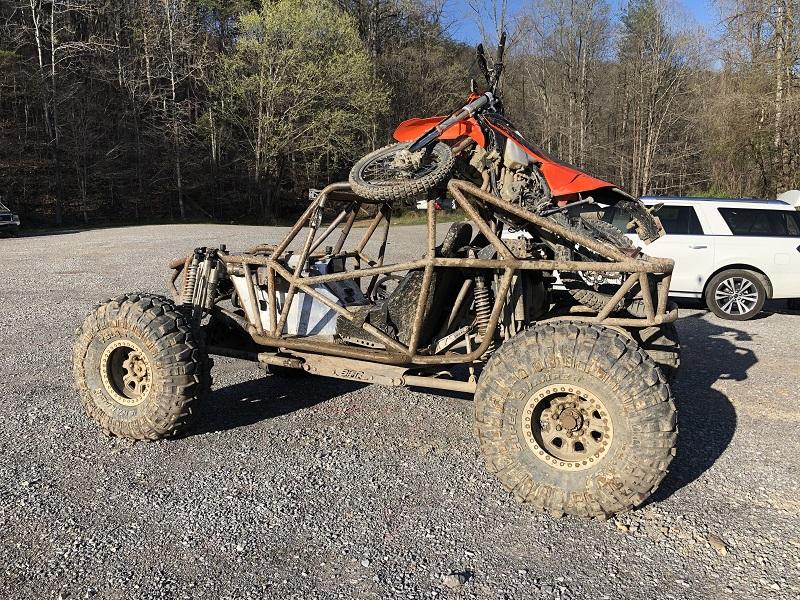

On the go:
Arrived at RBD:
Buggy in its element (I love these pictures
