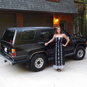

well, you could forgo the whole leaf spring problem, ya know....
I did. sure makes it ride smoooooooth...
better approach angle too.
I really gotta finish bending tube for a front bumper.
