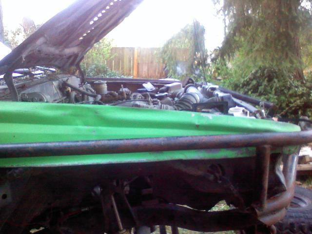

Anyone built a drop hanger in the front and how big? I need to add a wee bit of lift. i have ran out of things to trim and it still rubs way to much.. I was thinking a 4" drop hanger in the front and maybe adding a leaf? Any thoughts ?
Might as well go with a 4" body lift. It will look just as dumb as a 4" drop bracket :puke: and be just as stout on the trail.
Please don't install a 4" drop hanger. The previous owner of my rig did that, and it hangs up and looks retarded. I'm in the process of replacing it right now. Like WT said, keep cutting.
if i cared about lookin retarded id put a mask on lol...
Should i just keep adding to the packs then ?
And really i have nothing left to trim the fender is even with thge top of the hood almost
:redneck:

cut out around where your tires rub on your fire wall and weld in some new sheet metal. wheel spacers are going to make them rub worse:flipoff:
