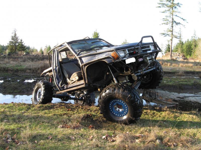

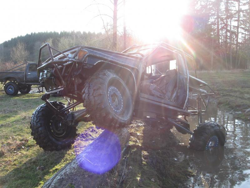

My truck clears 38.5x16WIDEx15rim with NO cutting. Both my fenders are stock in every way. I have nice flat springs and LOTS of travel. My tires do not rub anything but my steering box from turning sharp.
I can completely stuff it turned either way without hitting anything. My drive line is perfectly level and does not travel in and out enough to need an expensive long slip.
I have a drop hanger and a bodylift!!flipoff!!
clean stock fenders. Its all about axle placement.
