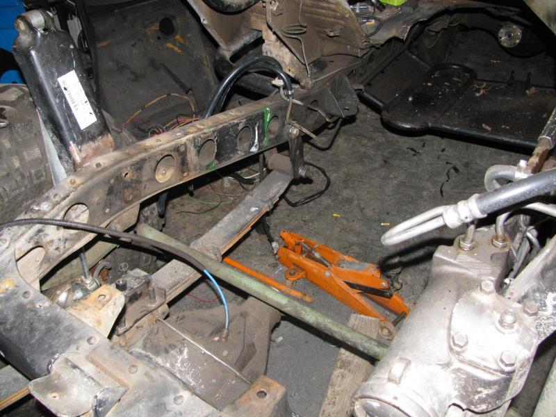

Wow. That's like a laundry list of good. Nice. :awesomework:
The drivetrain might be shifted over to give the steering shaft some room. 4" is a LOT though, especially when it's not that difficult to add a couple joints to the steering shaft.

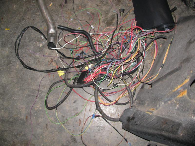

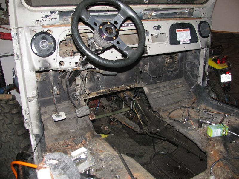

so I had to take a time out, had to PAY taxes this year. But things are coming back around again! picked up a tbi 350 with less than 25k on it!, stripped all wiring out. ben cleaning on the frame. AA is out of adapters that I need untill the end of this month and no orions..........so heres what i've ben working on

I leave wendsday back to louisiana to work for 2 weeks.........when i get back my trans adapter to my t/case will be here, my harness and computer from afi will be here.........so it's on!

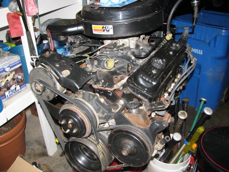

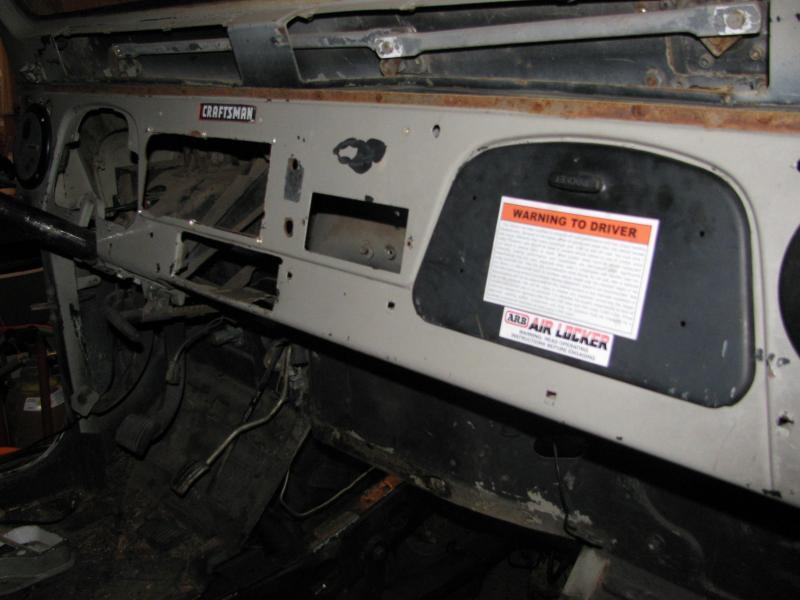

Git R Dun Tom!!!:cool: Funny how yer dash has an ARB sticker, and on your shelf is a Zip Locker box!!!:haha:
The bad thing is that in that zip locker box is a detroit locker!:eeek: wtf?.......got it off pirate for 200 shipped and looks brand new!.....it's for another cruiser i've got going! I do have an arb in the front of this cruiser:flipoff:
