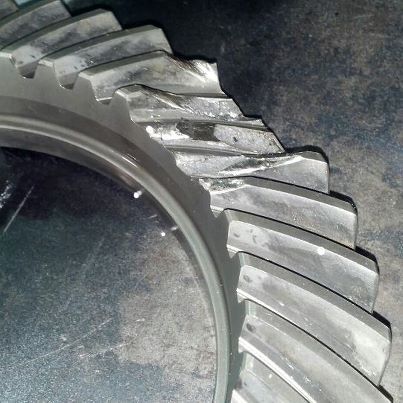

I set these up specs d60 lp 5.13s 6.0 cam n tune 44tsls BL 6 thou. good pattern middle of the gear. Made it two maybe three rides?

Elliott said:
Next time you need yours set up bring them to me and I will set them up for free just to make you a believer!!!! How's that for sack?
Where you located. I'm about to go to 4.56 in my lp60 cause the 5.86 wont take the abuse from a stock tbi350 and 44's. I promise you my gears lasting one wheeling season was not due to being set up poorly. :****:
