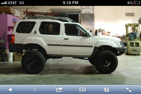

Was that X ever built? I remember a thread with a bumper and some stock sized TSLs but nothing more.
I had a frontier with 35s and a dana 44 front years back, but parted it out to build a samurai buggy that also got parted out.
I figure I'll give it a shot; if I burn up a $100 nissan case or 205 I can always put another one in and look at gearing the axles.
Xterras are cool to see built up, but due to the fenders you'll either have to chop it up quite a bit to clear big tires without lifting it to the sky or lift it to the sky..
I wil have to cut the **** out of the fenders and probably move the sterring box forward or better yet, go full hydro again - so I can move the axle forward.
There's room to shove a big tire in there; I think you see so many tall ones because people body lift a stock truck and then graduate up to a solid axle. I'm gonna skip the IFS build and go right to a well built 3 or 4 link.
