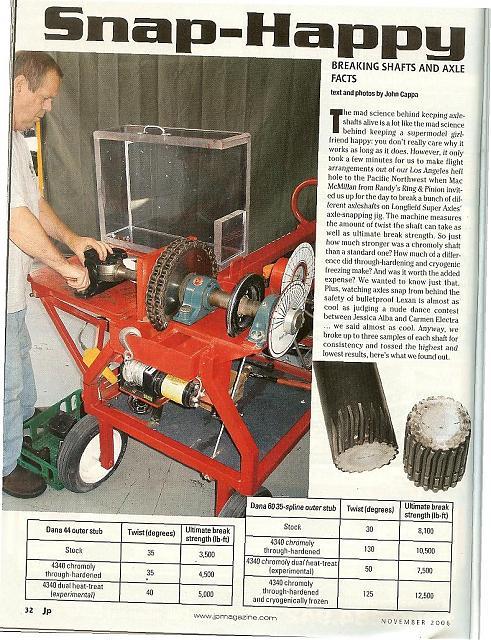

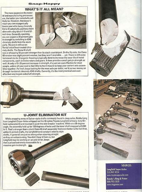

We always test the Dana 60 & 44 shafts that all the axle companys send us to test we put a pin throw the axle ears and test them streight, other wise you would have to use 2 shafts a u-joint to test them turned. We test all our CVs at full turn. WE did a lot of testing at Randy's at Randy's ring & Pinion a few months back it was a big wright up in Jp mag. There are pic. on pirate of the machine testing but i don't know how to move them.

Here Is The Article At Randy's Ring & Pinion in the JP mag november 2006. This is the best we can get the pic.
